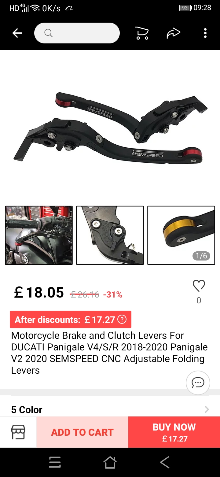

  3. Where to buy?
  4. AliExpress.com

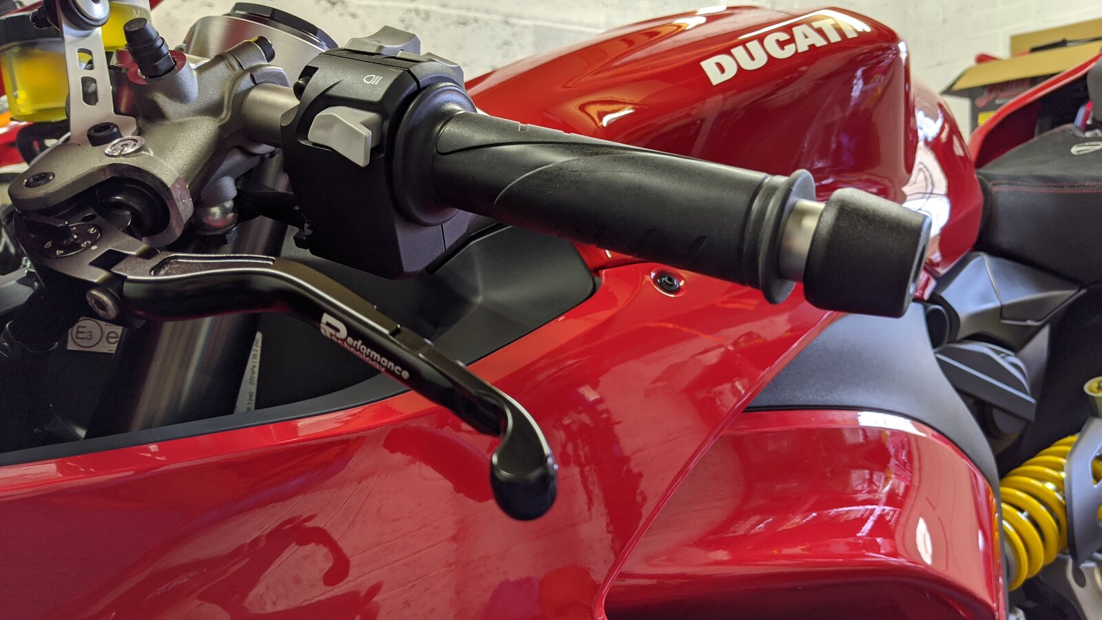

  11. I've fitted these https://conquestracingltd.com/produ...2-adjustable-folding-brake-clutch-levers-gp2/
    I had the Evotech ones, and whilst they work fine on my Blade with a cable clutch I don't like the feel on the Ducatis hydraulic clutch.
    As the pivot point on the master cylinder is a good distance from the bar, the lever travel shortens as its pulled closer. You don't feel this with a cable clutch as the pivot point is much closer.
    It felt like I had shorty lever which I don't like. These aren't as bad but still not as long as the OEM levers.
