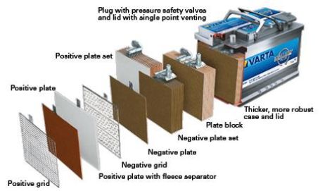

  7. Further to this for people who are unnaturally interested in batteries.
    The Standard Yuasa battery is sealed so that it doesn't vent and therefore does not need topping up with water (that is the maintenance free bit). In every other way it is pretty much the old type with lead plates (that is the weight) in a liquid acid bath. You can get similar batteries called gel types that are the same chemistry but the acid is gelled to stop it leaking.
    An AGM battery simply uses the same chemistry but different plates. They tend to use a mesh that looks like fly wire in stacked plates or in a coiled cylinder. This gives a few benefits due to the robustness of the plate design and the vastly increased reactive area of the plates that means the chemistry can happen faster. They charge faster, give higher CCA (crank the bike faster) and are supposed to be tougher against vibration. The last part depends on the plate design and manufacturer.

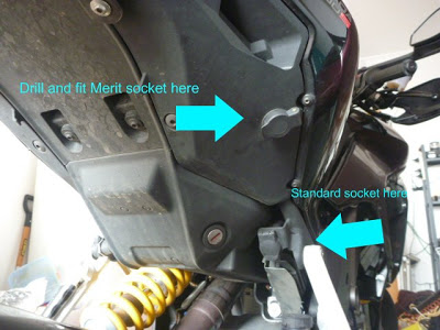

    Having said all that, my original Yuasa is still going strong after 2.5 years and I look after it with a battery tender. I made it easy on myself by fitting a fused Merit socket under the right side panel and wired a merit plug to my battery tender.
    I just plug it in if I am not using the bike for a few days.

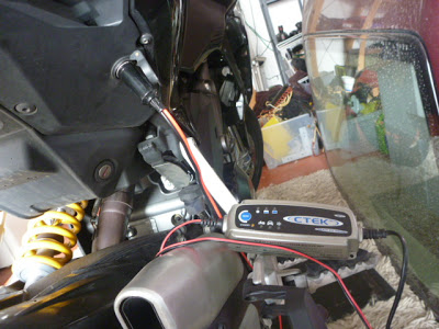

  9. Same battery charger as me Tim I see....great piece of kit
