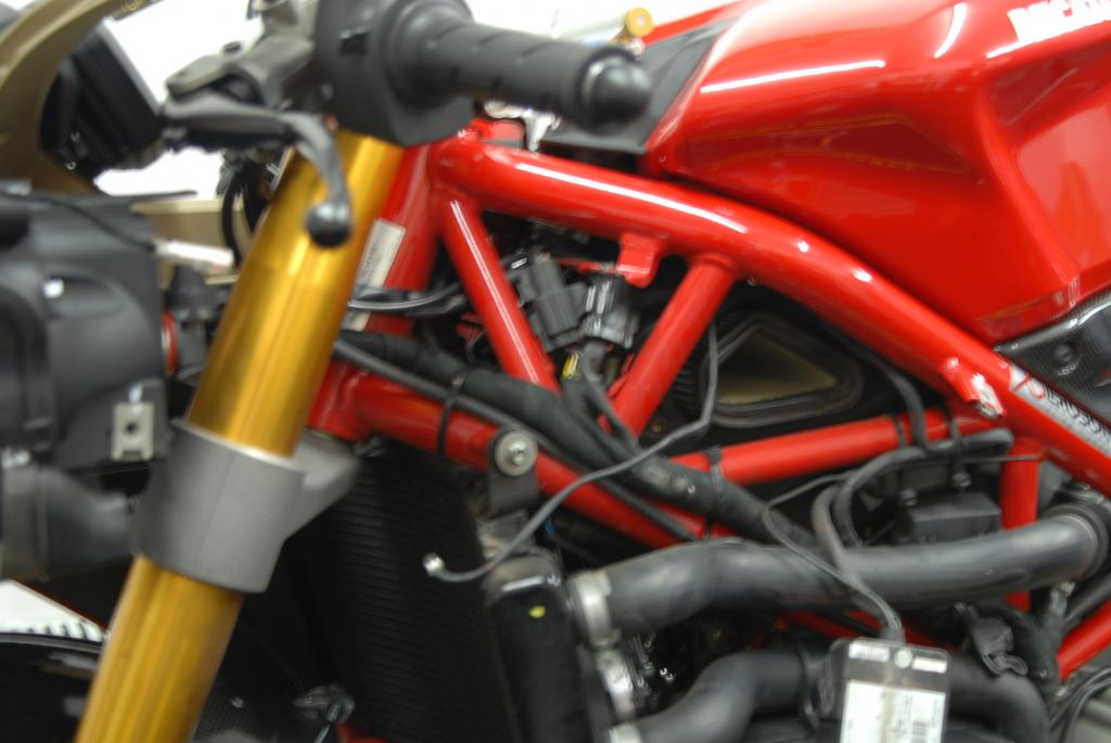

    then remove side panel then both the air tube covers (under the handle bars)

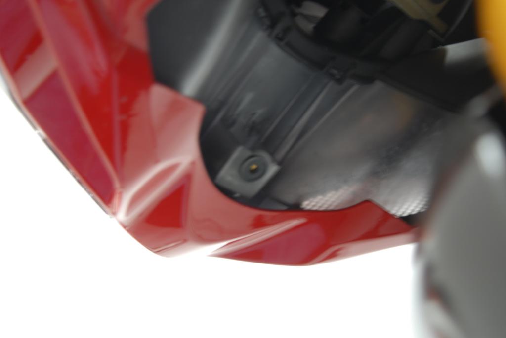

    Next up is the black plastic shroud under the headlight, this needs to go

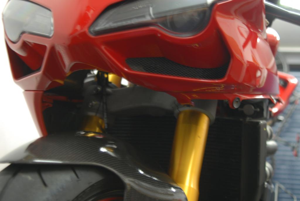

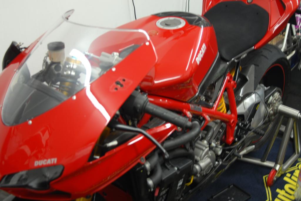

    next the headlight fairing needs to come off...... But I've been told it's possible to change a filter without having to take it off. If you do it this way your a better man than I, you'd have to bend the fairing out the way........ Fuck that.
    firstly remove both mirrors, it's just a bolt and pop them out. There are a few bolts holding it on, when they are all undone it'll come off dead easy, so worth checking there all out, bottom pic shows a hidden one.

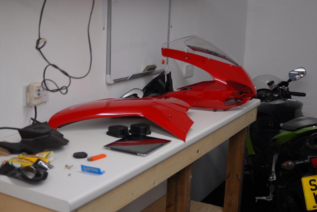

    you should end up with a pile of bits like so, for obvious reasons get them up out the way.
    ok, next up remove the air tube, the filter will slide out easy, replace filter and refit parts in reverse order.
