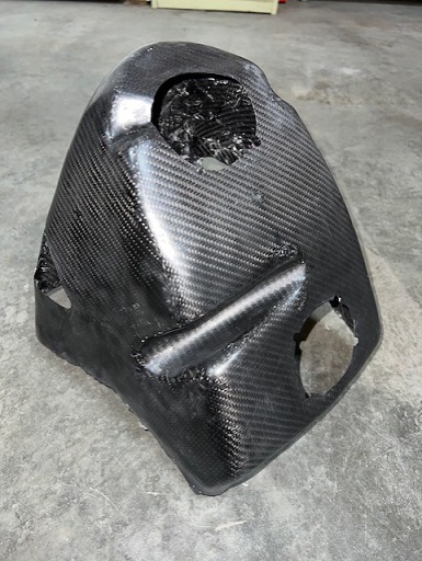

  1. So I've had a crack at making an RS-style airbox for my junkyard dog 749R/999RS project. It's nothing pretty, only vaguely Corse-ish in that it will seal against the underside of the tank and all RS similarities pretty much end there. But it will do the job:
    It's kinda tricky to measure the volume of the thing given the shape and size....that and I'm not very smart, but a conservative measure indicates somewhere just over 15litres.
    Anybody know the volume of an OEM 749/999 airbox? Given my mung bean intake setup (1098 TB's, Jetprime intake manifolds etc) and the tank, I had no option, but I'm just curious.
    NB: management reserves the right to withhold any and all correspondence regarding resonance and other bullshit that Ducati never considered at the time of construction.

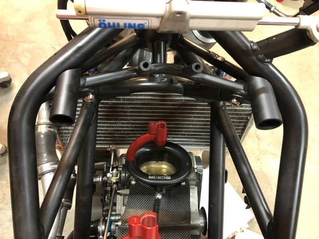

    The other question rattling around in my scone: have Ducati made the frame brace/tank mount bracket removable on the race homologation models (749R/999R) because they intend for it to be removed? Or does it actually serve a bracing purpose?
    I'm talking about this lil' fella:
    It was a ball-ache to work around (allowing access to the bolts, sealing around the tubes etc) not to mention is a lump of possibly unnecessary steel. The RS/F0 frames don't have it, so did Ducati make it removable because they intend you to remove it for a race application?
