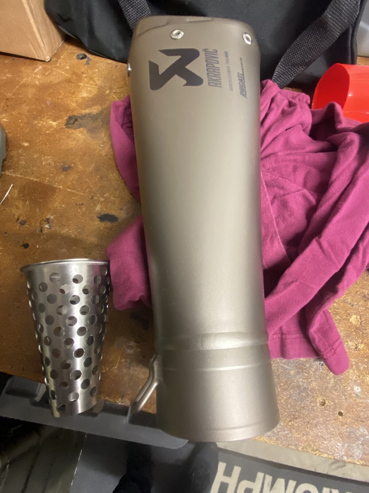

Hi I was wondering if someone could help. I’m trying to fit the akra baffles to my slip ons on my SFV4S. I want to see if they make much difference because they are crazy loud. Does anyone know which way the cheese grater fits into the belly silencer please ? Thanks guys
I’m thinking it drops into the silencer on the inlet side small end first. 50/ 50 I will probably be wrong lol

thanks for the link but I got the akra baffles supplied with the exhaust. The right hand side is easy. Just drops in the end and secured with a grub screw. However the belly left hand exhaust you have to remove the end can and place between the link pipe and the silencer. Just can’t decide which way it should sit. Small end at the front or big end?
drop it into the silencer small end first so the large end sits in between the pipe and the silencer....
I have a full system and there were 3 baffles, two go into the exhaust and are half in with grub screws (1 either side) the other part which I think is in your pic goes in with the small end away from the exhaust, well that's how mine goes in.

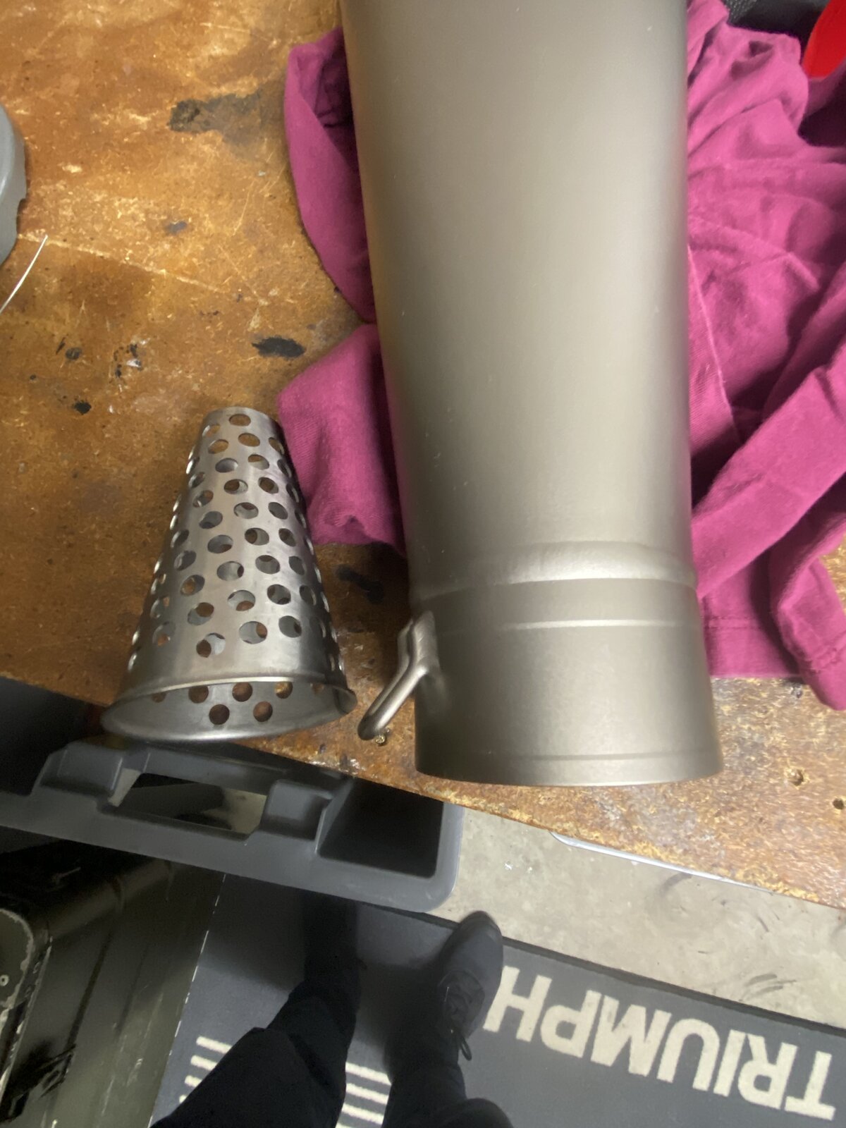

That’s awesome thank you. Yes there is 3 bits in total. When you say small end away from the exhaust do you mean small end towards the back of the bike ? Like this picture below ?
Thanks Andy sorry just seen your post. That’s brilliant thank you very much. I shall get it dropped in and reassembled tonight. Hopefully might knock a few decibels off. It does sound wonderful I have to admit !!
Ah ok lol I might have to try both ways and see if there’s any difference. An arrow mark on the baffle showing forward would be useful !

It appears you are right. I got a response from Ducati Preston who consulted their technicians. The pointy end goes into the down pipe and then the silencer slips on after. Just started the bike tonight and I have got to say they made cock all difference haha !!
