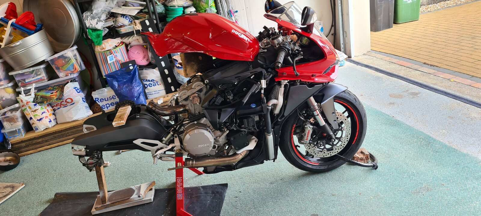

    I've recently done the swap from standard to termi's on the underbelly exhaust on the 899 - Its a easy job but the bolts were completely corroded, making it impossible to remove - In my case, the entire rear sub frame came off and I split the exhaust pipe behind the rear cylnder to remove the underbelly exhausts - Massive job becuase of the corroded bolts on the y piece connecting the cans to the pipe. (Pic attached, applggirs for the wifes mess in the man cave).
    Never done changed the cans on the 959, so others will have to comment but it looks like it seperates below the Carbon cover near the foot pegs. Searching for 959 shotgun pipes on ebay (see item id 134104312000) seems to suggest its just a two bolts and it will drop off, judging by the pictures. Good luck!
