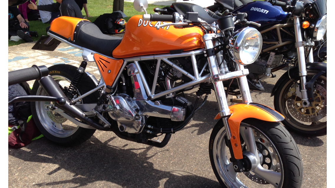

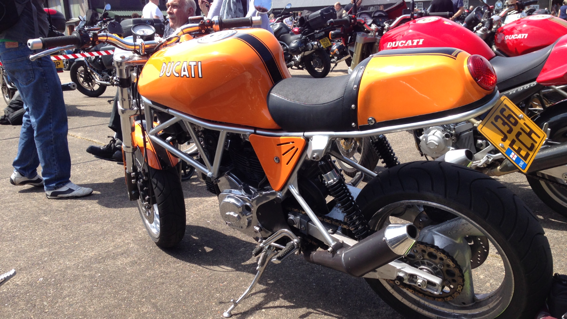

  12. IMG_0159.PNG IMG_0158.PNG Heres a SS converted to twin shock. Tidy job. It looks like he's flipped a standard SS arm so the original shock support on the arm becomes an under arm brace.
