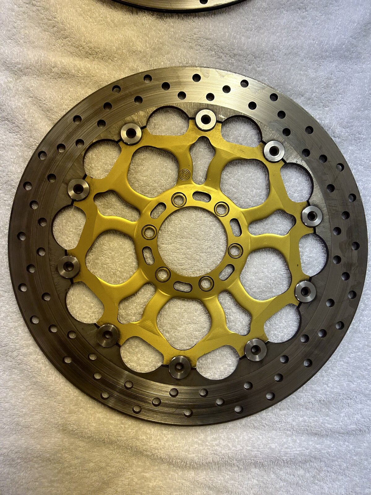

  1. Hi all,
    Just found out that the cast iron rotors of my 851SP3 are at the service limit (4.5 mm).
    Brembo don't make these anymore, so what to do?
    I am considering two options right now.
    Prefered option: Braketech AXIS IRON RACE SERIES
    Cast iron which I was used to (and liked very much with the Brembo Racing RC Carbon 07BB15RC pads)
    Problem is I can't find a European retailer who sells Braketech. Shipping from the US and the import tax will make this the more expensive option (780 USD + shipping + import tax etc)
    Fall back option: BREMBO HP T-DRIVE DISK KIT
    the stainless steel alternative from brembo, approx 700 euro
    Was wondering what your experience is with either of these rotors for track use, what would you recommend and why?
    And doesn anybody know how to buy the Braketech within the European zone?
    Hoping for some input, TIA,
    Jacco

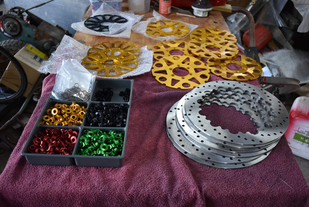

  5. There is a guy( in New Zealand I think?) who has made copies of the aluminium carries for fully floaters. I have a set in loft for my superlight, which at 28k need doing.
    I'll try to dig link up on Facebook pages.
  6. SRM Performance Products, New Zealand.
    Think he dose aluminium carriers & discs, better than original quality at a reasonable price. You may have to go on Facebook to find company.

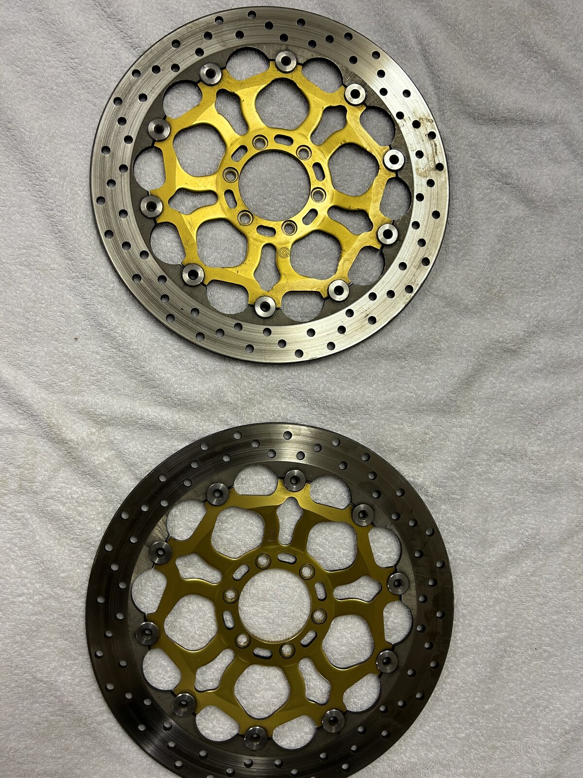

  7. I think the SPS rotors are the same, so they should fit.
  8. I also have an extra set of carriers. But it's the discs themselves that are at end of life with 4.5mm thickness :-(
  9. when I look at pictures there's a difference between 996SPS and 916SPS. The cast iron rotors fitted to the 916SPS look the same as on my SP3 and I think are identical.

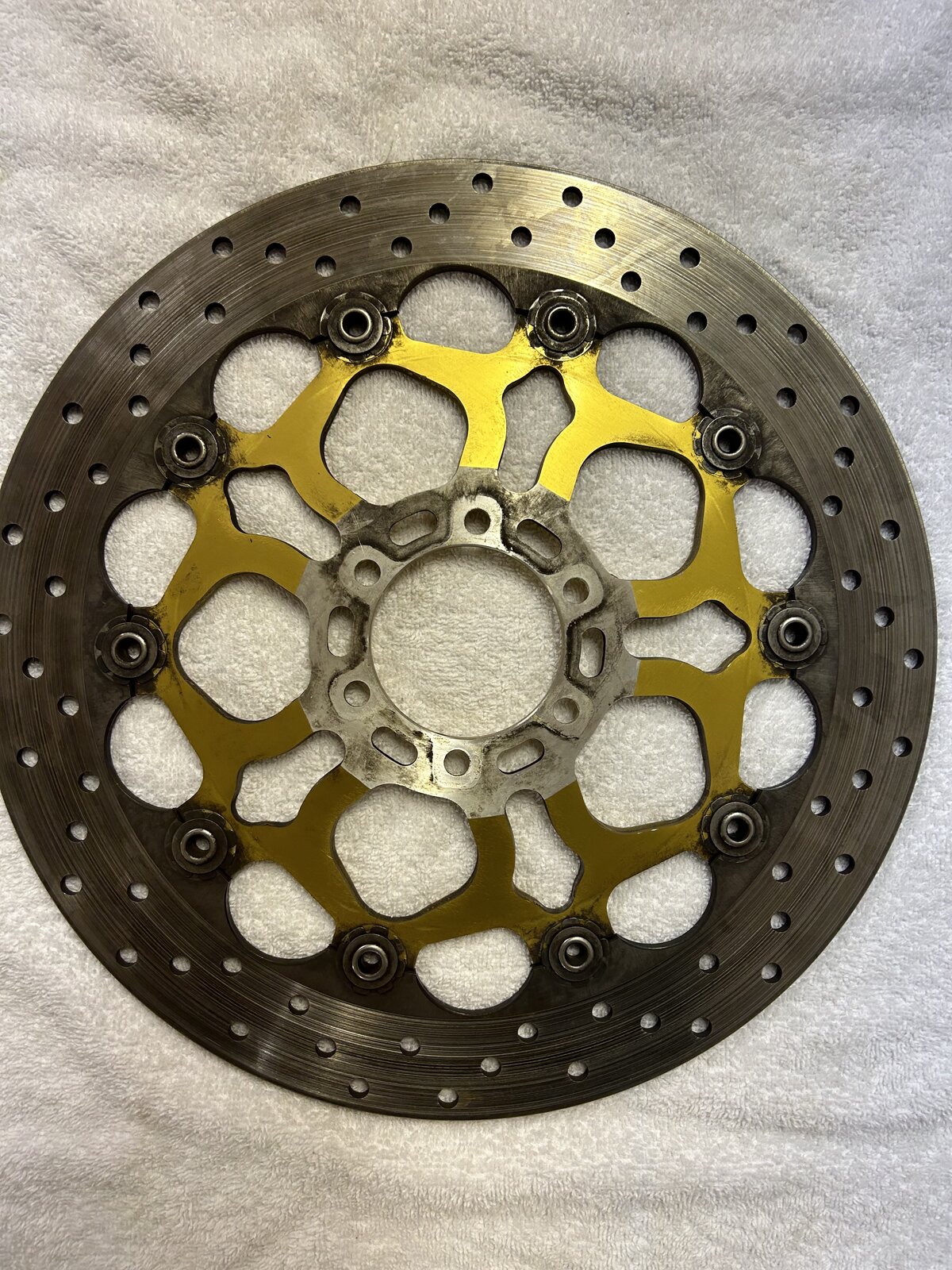

  10. Here they are. USED. 320mm. I will try and measure thickness.
  11. Think he machines discs as well as carriers.
  12. Pic from page

    Your disks look to be in good condition ..... no deep scoring , and much more importantly ,
    no visible ridge on the outer rim of the disk .
    PS - if you are going to be chucking them in the bin , please chuck them this way .....

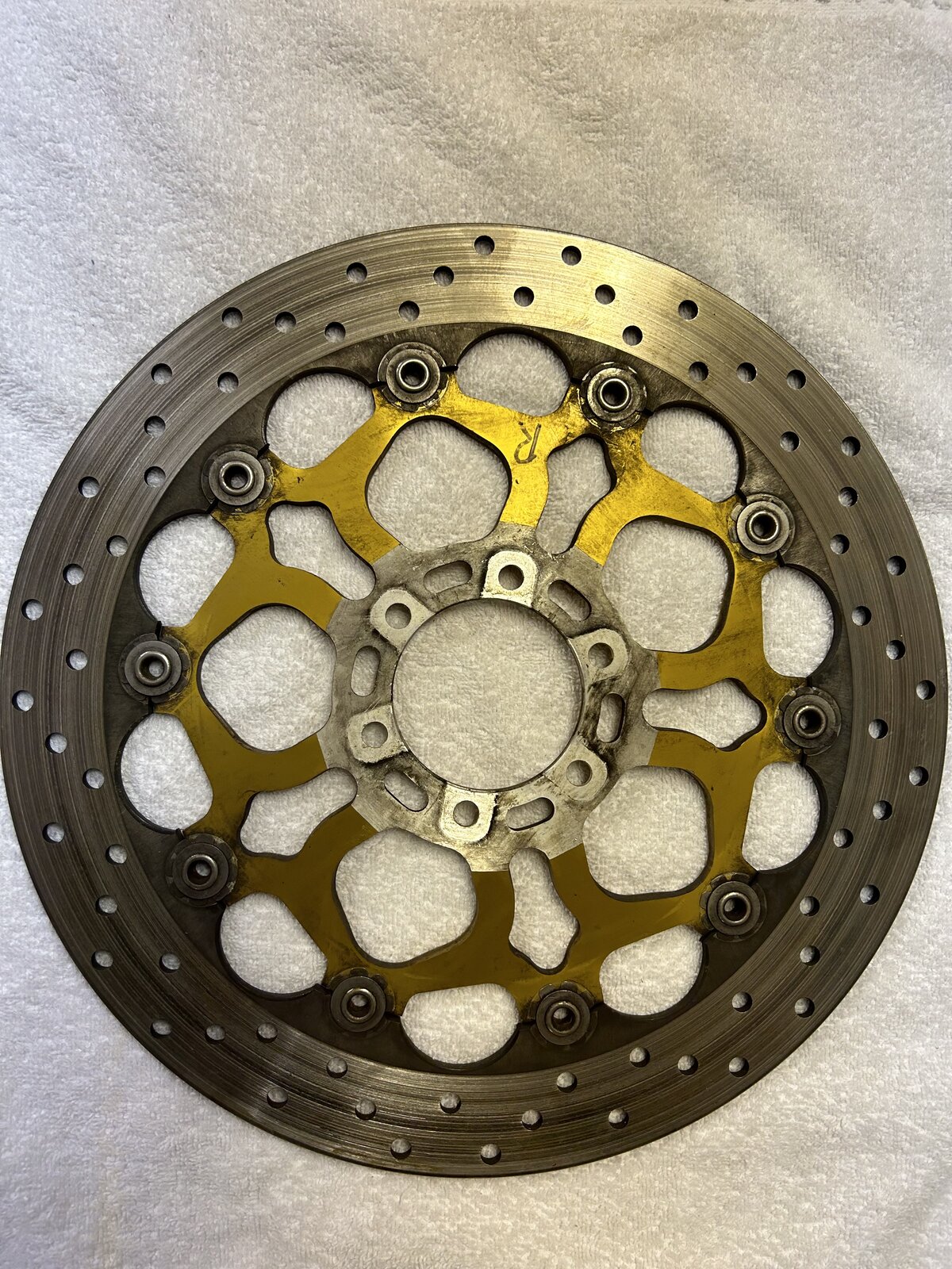

  14. Mine look like 4-5mm.
    If that is insufficient for OP, then @oldtech they can be yours for a modest sum + P&P or delivered if you London & SW.
