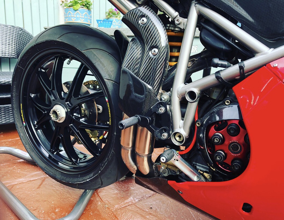

  6. I run the marchesini m10r wheels on my 998 3F52F4B5-E9F3-4979-B52D-0B273237B879.jpeg
  7. my favorite wheels of all time
