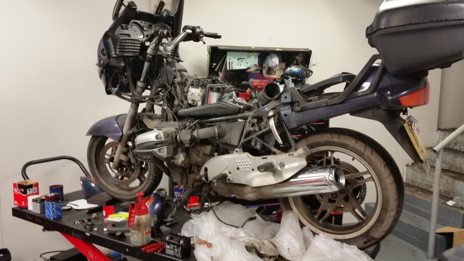

  7. I regularly service two of these at work, neither owner cleans them and they get ridden in all weather.
    To be honest although they have surface corrosion it doesn't get any worse and they both have good milages on them 60,000 ish.
    A month back we had them both in, and noticed they were the same year on the reg plates.
    Looked at the frame numbers and one ended 101 and the other 103, next but one off the production line!, they weren't original sold locally either so whats the chances of that.
    As others have said you need to remove the corrosiln with elbow grease and brass brush/ scotchbrite etc but to be honest I wouldn't spend too long over it
    May be worth treating it with ACF50 while the panels are off..
