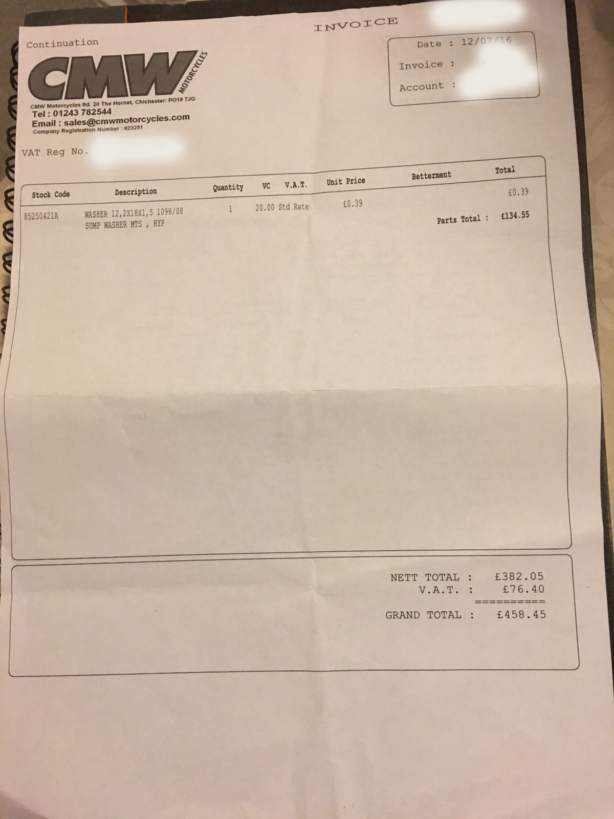

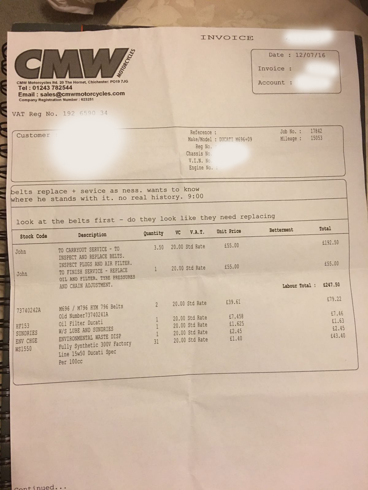

Got these pictures of a seller of 696, of the recent "full service" but am I blind or the valves were not done? If not, how come? Am I missing something? Shouldn't they be done 7k interval and full service should include them? It looks like quite expensive service too..
Hi,are CMW Authorised Ducati main agents or just a specialist motorcycle sales/service garage? If not there is your answer
Well I'm no Ducati expert but there are plenty on here! I see at top of invoice it states "no real service history" which probably points to non franchise/specialist servicing? I would get it checked out fully if you are going to keep it?
Valve check every 7500 miles or every year whichever comes first and belts every 15000 miles or 2 years whichever comes first, as stated in the Service/Owner's manual. Andy

It is odd to my mind that the seller should say to the workshop that he wants to know where he is if as the ebay ad wording states he has the service book. You have the registration number so a quick phone call to an authorised Ducati workshop should tell you if and when it was last serviced by a dealer. Might put your mind at rest or just confirm it's just not quite right. Also odd the guy has been a member of ebay for 8 years and only has feed back from 3 transactions as a buyer. Andy
They used to be and I think it was taken away (Chichester, right?!) also had a pretty poor rep amongst the guys I know that way. How big a job is valve clearances? Bearing in mind most probably don't do them once they start home servicing anyway...
Yeah I am pretty sure to do valves it's like 500 quid and then I need to take it to a ducati garage, which I have 0 nearby (100 miles away)
Seems a bit pricey for the mileage. The termis are nice to have though. I would still hold out for a better one.
Agreed. Valve clearances don't change with time, only with mileage done. They only need checked every 7,500 miles and adjusted if necessary. Oil & filter should be changed every year regardless of mileage.
