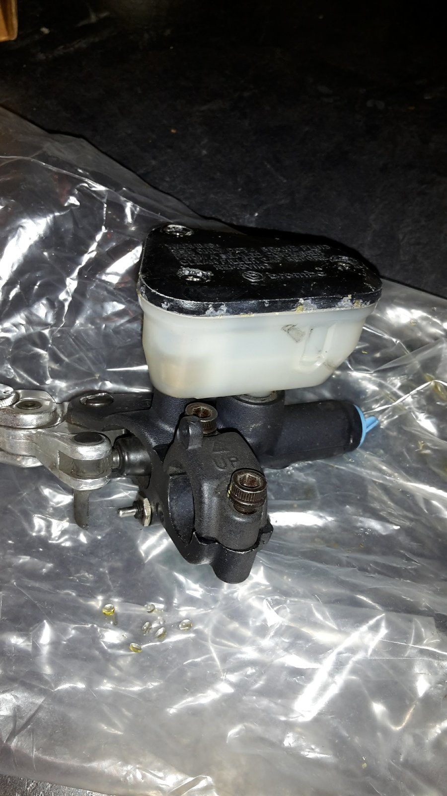

  3. Hi Johnny. Glad you got the bike running again. I have the same bike as you and after replacing my clutch slave I also replaced the master a while back. I had some dampness at the peg where it fits into the boot. I put it down to some fluid getting passed the cylinder when the system was pressurized again when I bled it after replacing the slave. For piece of mind I decided to replace it anyway. I had no luck with a rebuild kit. Everyone seems to be frightened of litigation. I think you can get the parts if you are confident of the cylinder bore size etc. etc.
    Anyway I kept my old master - this post is full of double entendres isn't it :) - and I was going to ebay it but as it would have to be sold as not working I didn't bother. If you want my 'working but may be leaking' spare you are most welcome. I'll keep hold of the lever but the rest is yours if you want to use it for spares or as a swap to help in the diagnosis. You may find that it works OK anyway. Old_master.jpg

  5. Thanks guys.
    Raynewalk - Cheers for the great offer. I spoke to the dealer whom told me how to bleed the master. It worked like a charm. Now I have full operation.
