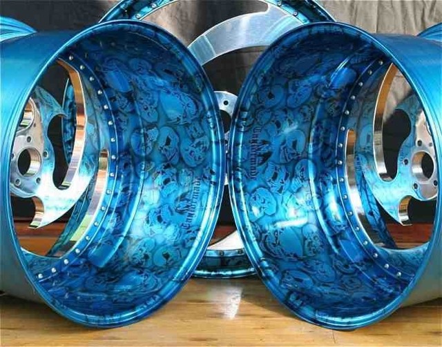

    Il see if I can upload a picture of some wheels he did not long ago.
    I was sitting having a cuppa while they bubbled away.

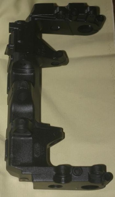

  8. ImageUploadedByTapatalk1344056367.308721.jpg ImageUploadedByTapatalk1344056406.055781.jpg
    Some stunning custom wheels black and blue anodising ( 2 colour) and black anodised cast alloy swing arm.
    Dead good!
