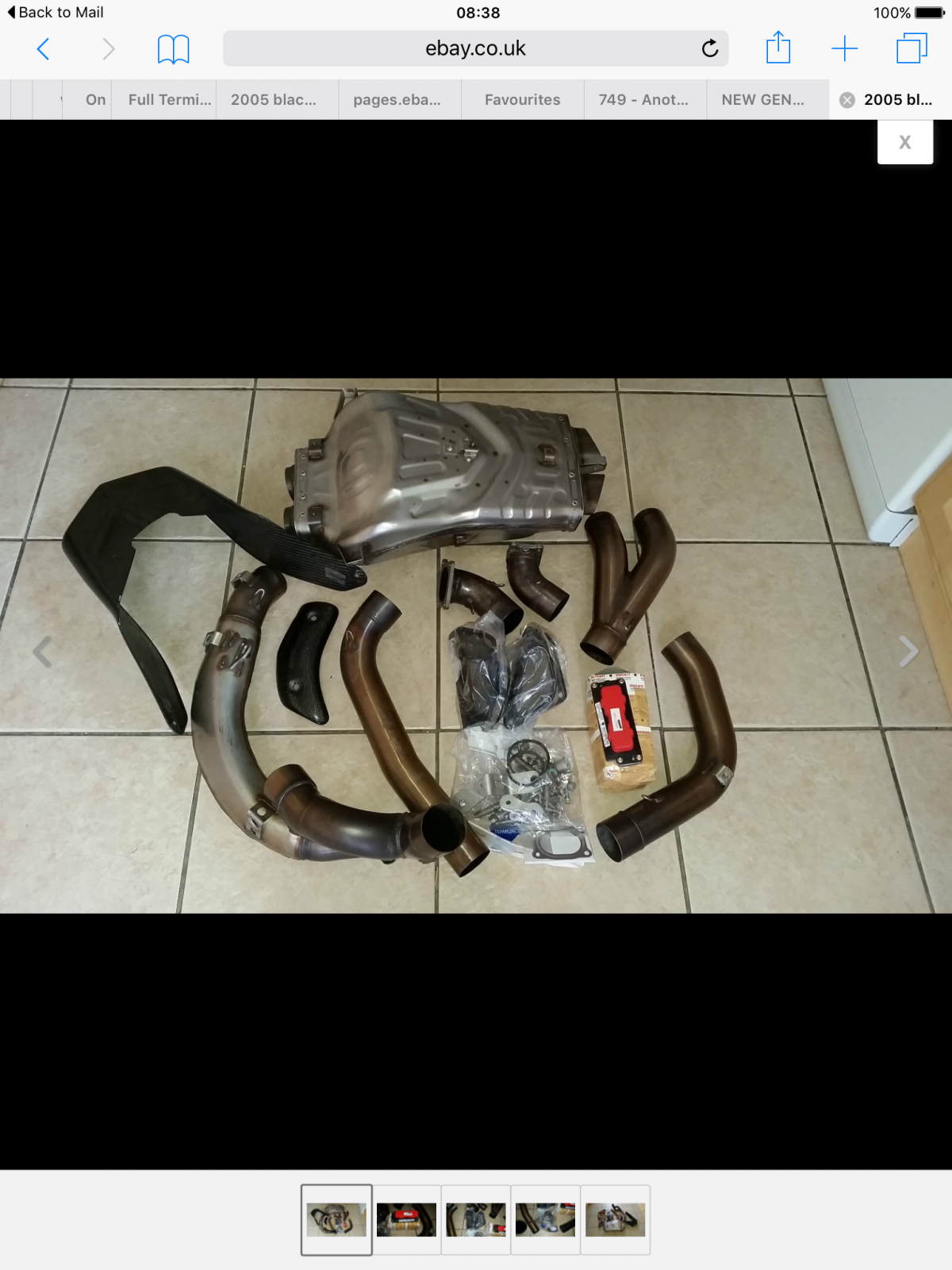

    I've just bought a 54mm full Termignoni system for my 2004 749r from flea bay.
    Apparently it came off a 2005 deep sump, black swingarm 749 so I hoped it would fit.
    However on trying to fit it today the sump appears to be in the way!
    So my question is: are all deep sumps the same and how does the deep sump system differ? Any advice would be appreciated.

  3. Thanks for your comprehensive reply. Apparently it came off a 2005 deep sump, black swingarm 749, so I assumed it would fit my bike. Hopefully a picture is attached. Unfortunately Termignoni don't seem to stamp part nos on their exhausts making it more difficult to identify.
    I've not given up on trying to make it fit, but it's not looking likely.

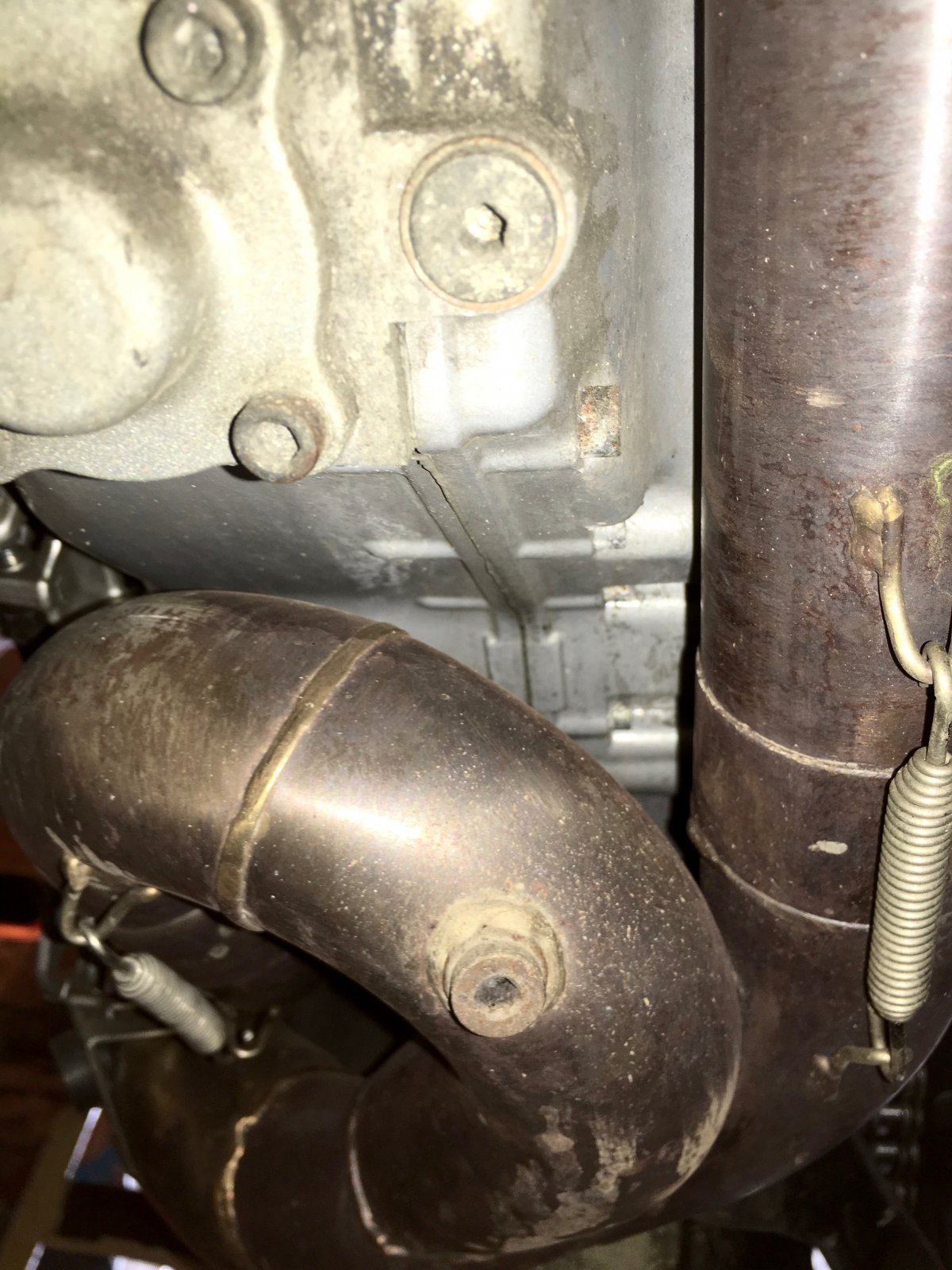

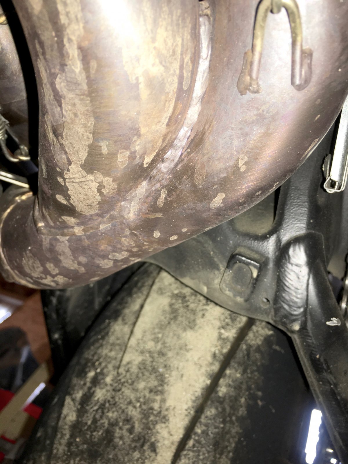

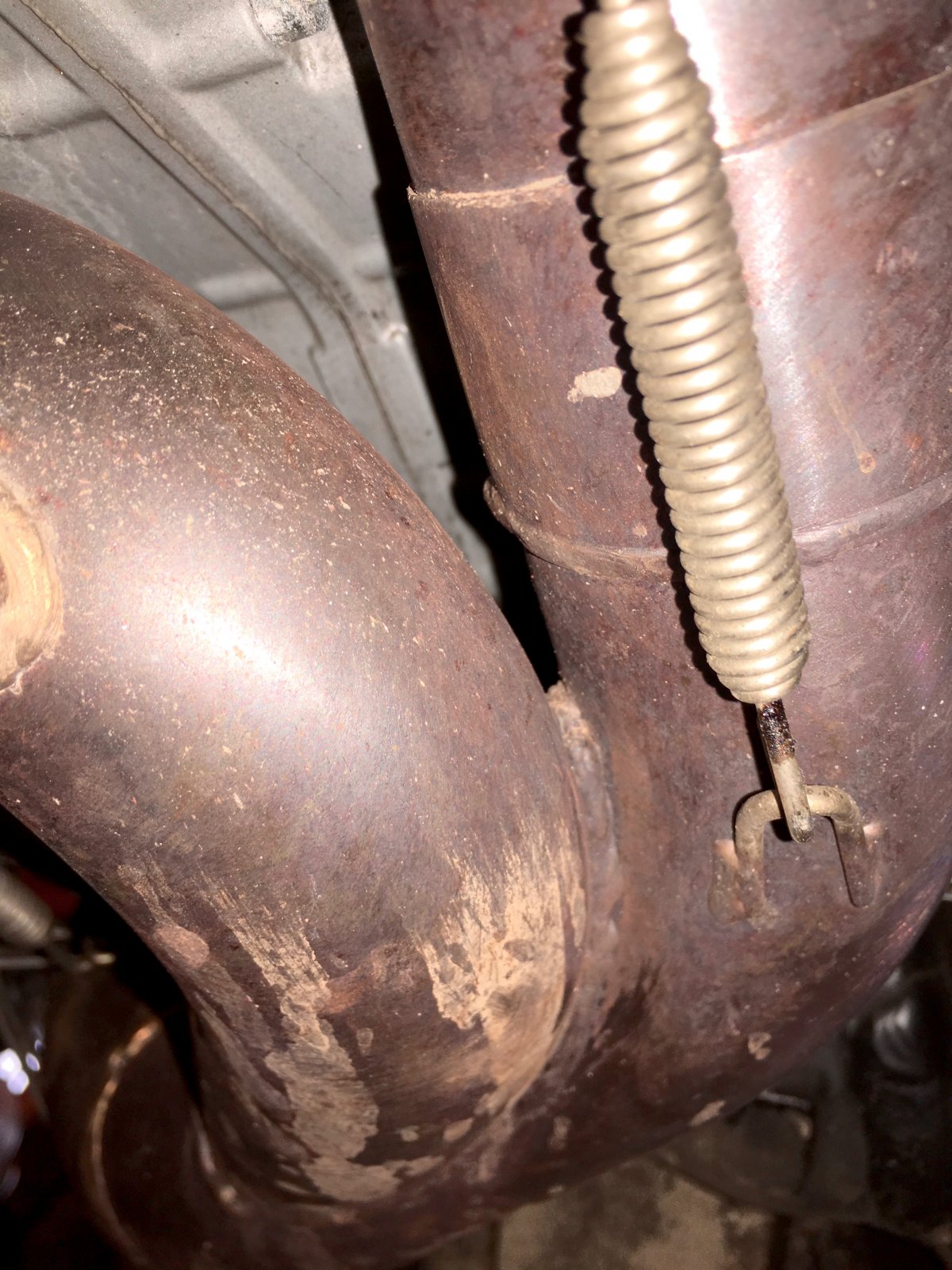

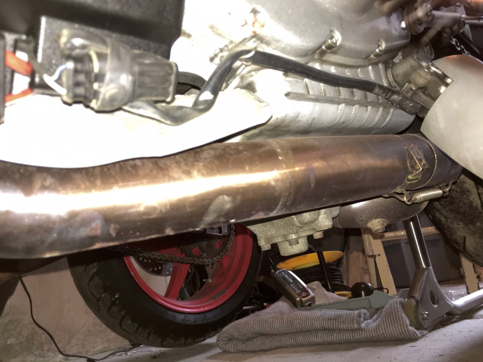

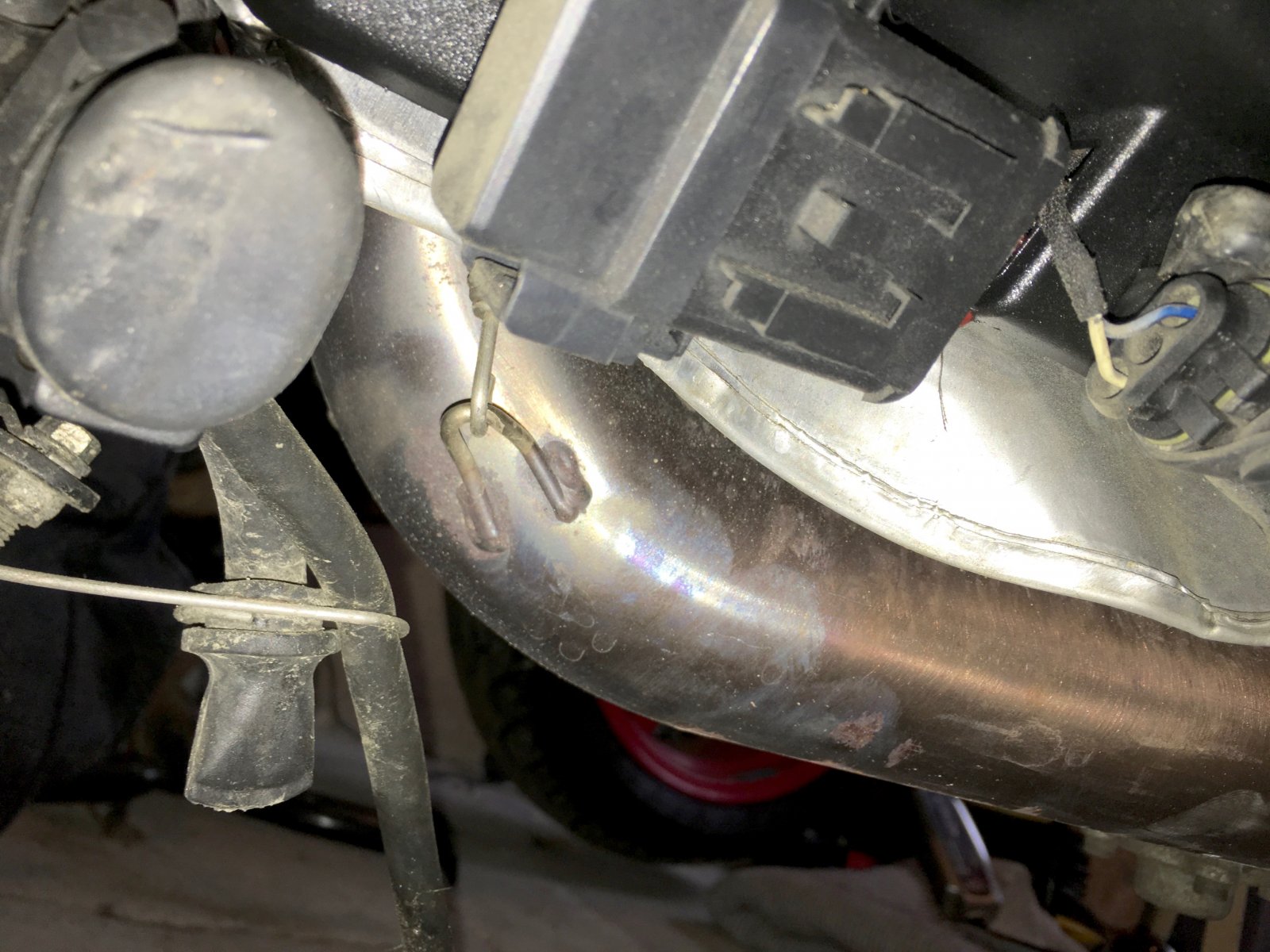

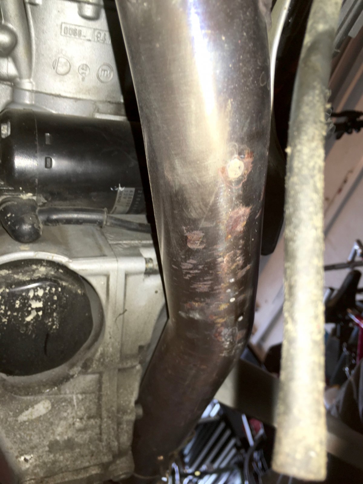

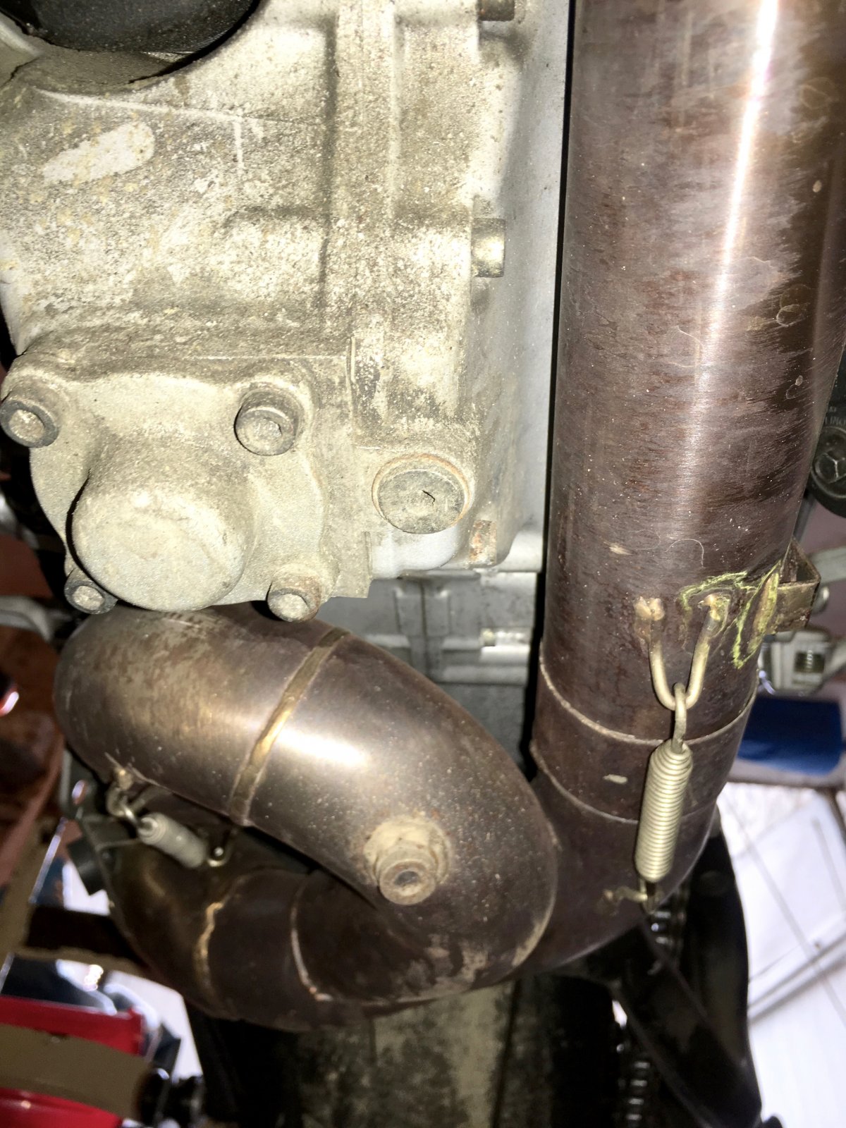

  12. Sorry about the delay - here then some pics of the fit below my engine - hope they help! (I was going to wheel it out of the stable & get better pics but it's currently pissing down! IMG_8068.jpg IMG_8058.jpg IMG_8060.jpg IMG_8062.jpg IMG_8065.jpg IMG_8066.jpg IMG_8067.jpg IMG_8068.jpg IMG_8058.jpg IMG_8060.jpg IMG_8062.jpg IMG_8065.jpg IMG_8066.jpg IMG_8067.jpg IMG_8068.jpg IMG_8058.jpg
  13. Where's the problem?
  14. There isn't one: the pics are of mine, which is fitted just fine, to show the OP what the full 57mm system should look like.
  15. Proper 57mm system but....a very dirty one!
  16. Forgive me for riding my motorcycle… …and there can't be that many 749Rs that live a mile off-road…

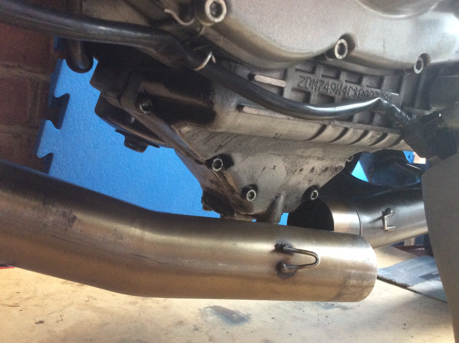

  17. Thanks for that. Very helpful. I managed to find some photos online of the 57mm system and it is different.

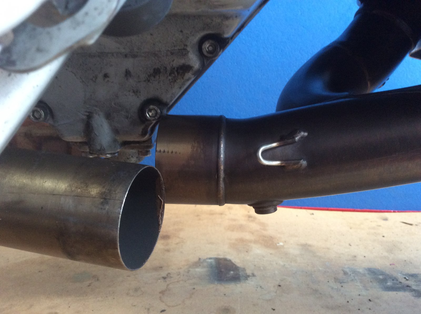

    I'm convinced that mine is for a shallow sump model.l have fitted it as far as possible but as you can see, the sump is in the way.

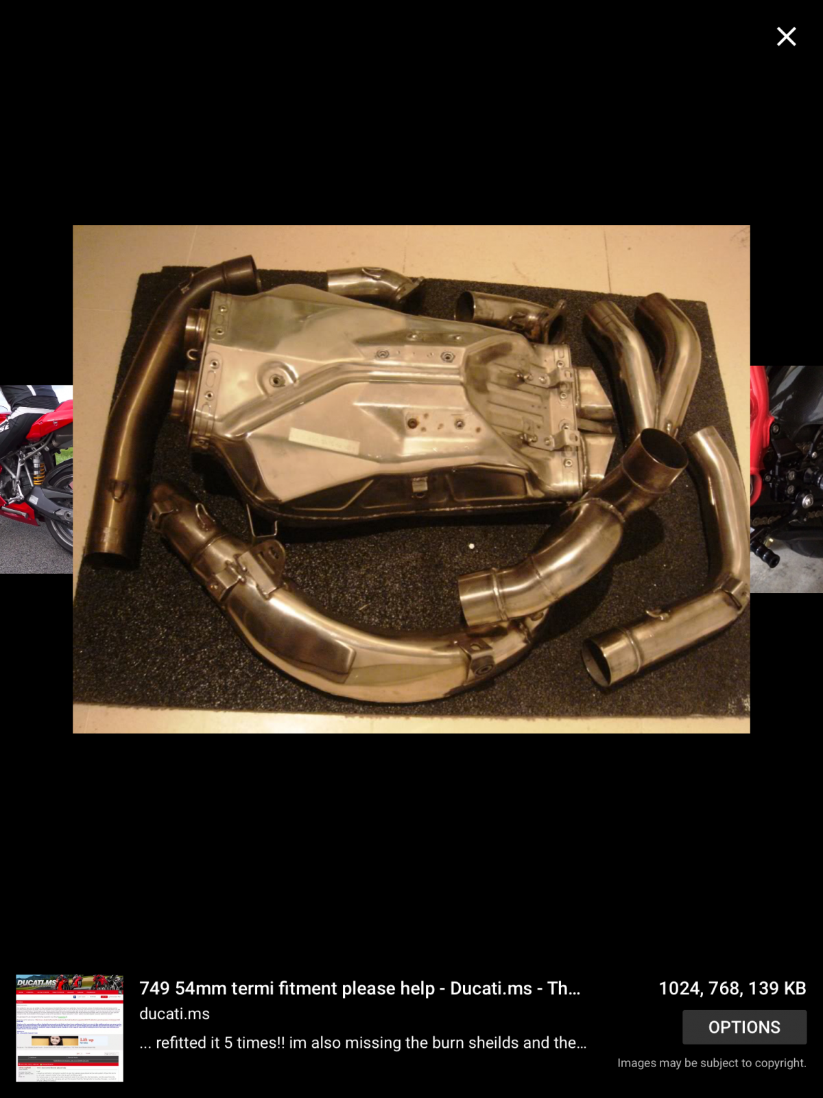

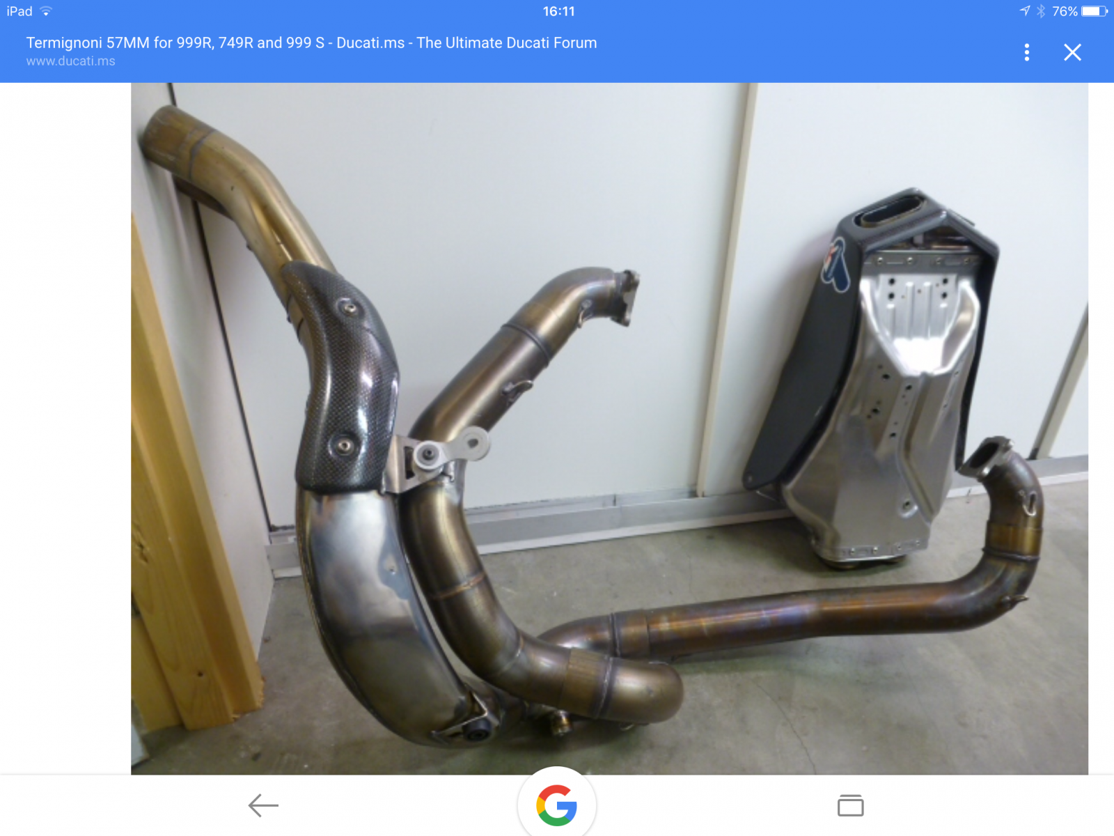

  18. Ps here is a picture of the 54mm system I have and also one of a 57mm system.
  19. From the various pics, it does look like yours isn't anywhere near missing the sump - and there's not that much leeway on the rear section to allow it to meet the header. There does seem to be some debate about whether the 05/06 non-R bikes went to a deep sump - I've seen pics that appear to show both sumps with the black swingarm.
