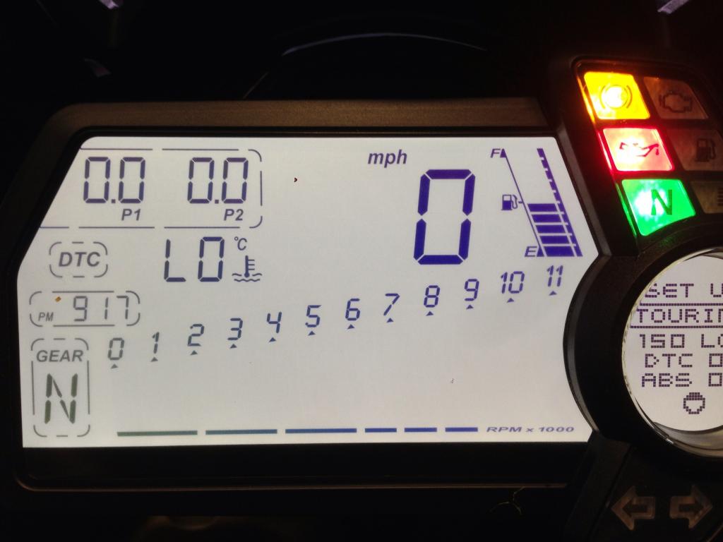

  1. Anyone got any ideas what the display is top left in the odo/trip section. It has appeared after first service on my Multi GT. The sequence is odo-trip1-trip2-then as per photo.
  2. I think you've got it in lap timer mode.
    The P1 and P2 are your lap times...hope this puts you in the right place in the handbook.
  3. Would you have any more info on this. I've gone into the lap settings and made sure it is switched off and I've reset the memory but no luck in getting rid of it. Funny thing is it doesn't seem to do anything other than stay at zero when the bike is stationary but when it's moving then the zeros become four single horizontal dashes. Using the headlight flasher/lap start doesn't do anything either. I'm only curious.
    N.B. Looks like the good folk at Ducati Manchester have solved it. I had the electronic fuel cap fitted at first service. In order for this to work, some auto electronic features need to be activated. One of these features is apparently tyre pressure monitoring (not fitted to my GT and I've never heard of it) and this is the display for the tyre pressures.

  4. Oohhhhh, now that sounds interesting...
    So maybe a TPMS is on its way after all (expected on the first bikes, so only 3 to 4 years late).
    Odd that they need to enable the keyless fuel filler, as I don't believe they needed to on the 2010 to 12 bikes. All I did was plugged mine in and it worked.
