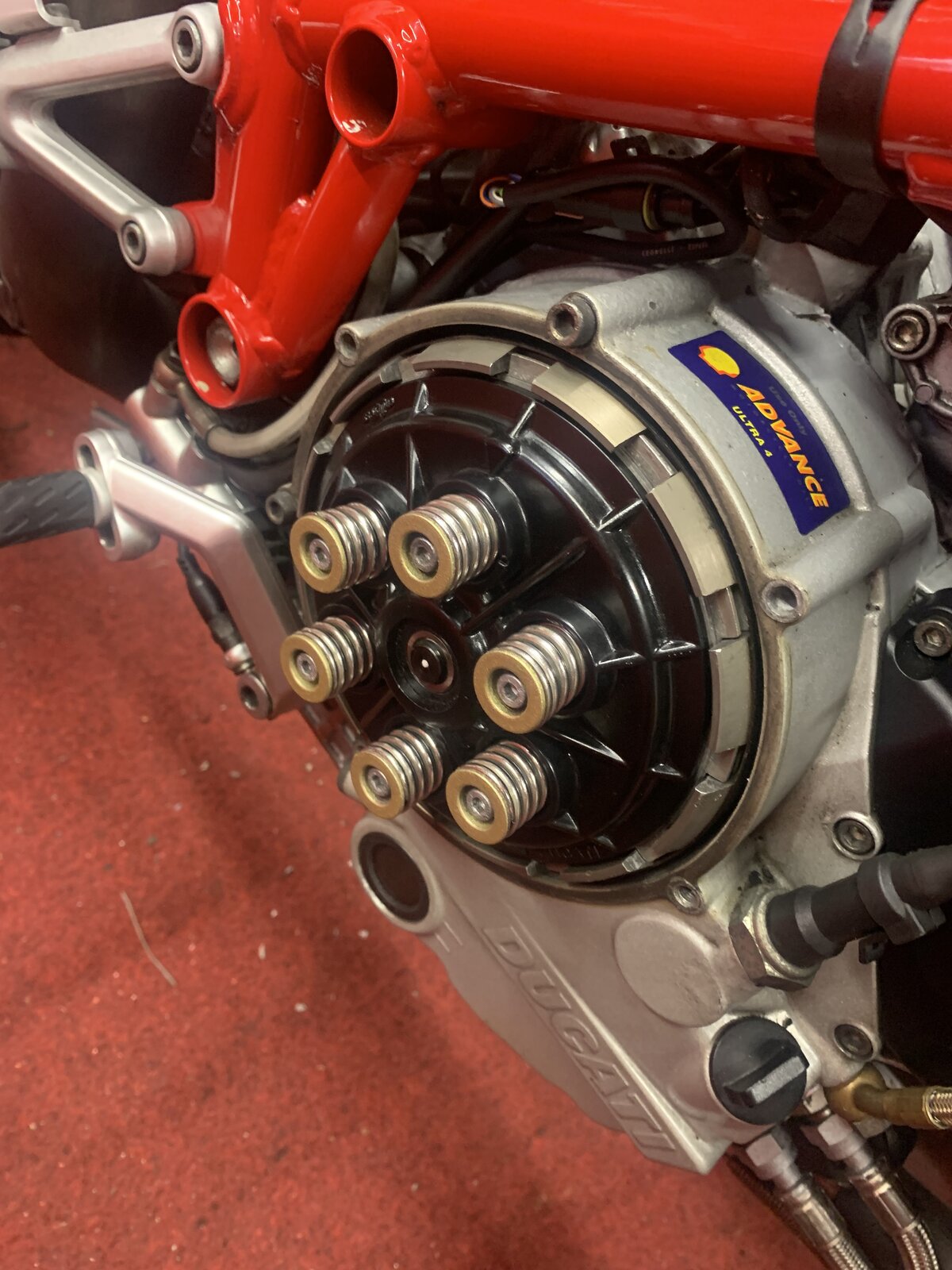

  3. Ok so built it back up with a stack of 37.2mm seems ok , only on paddock stands but selected first and could go back to neutral . Same with second . I appreciate it needs to be ridden to prove all is ok

  5. that basket looks better than the one you removed from it
  6. A lot better , it was my first major job on the bike since it arrived and whilst I haven’t proved it’s working it was interesting task and great to feel a sense of achievement
  7. Surely you jest
  8. That looks good, are they allow plates in alloy basket? The steel ones are much louder.

  9. Guilty as charged... But the sacred God of rattly clutches won't be too happy!
