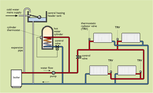

You MUST have one radiator without a TRV or a Bypass, just look at the diagram above and ignore the T to the coil, as yours is via a motorised valve. If all the TRV's are shut you get no flow. The radiators are "wired in" parallel, so water can flow when the TRV is open. If the system was done as a ring the water wouldn't flow through the radiators properly as they effectively present resistance.... the water will flow through the easiest path. The bypass effectively allows a ring to be made ONLY IF all the radiators TRV's close. Your system (@Arquebus ) would normally have the main bathroom towel radiator as the manual bypass. If you were to shut it and all the TRV's were closed you'd hear the pump dead heading, also the boiler overpressure/temperature may operate to prevent a steam explosion (depending on the position of header tank connection). You may have other safety devices around the boiler, but the idea is that should all the options to reject heat absorbed into the water are closed, at least one radiator would be available to allow heat rejection. One of your plumbers knows his stuff and the other needs to have his number deleted out of your phone. My facepalm for the diagram is that we may have assumed what Al meant by conventional...
