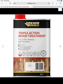

  1. I’m about to treat all the wood in my house. We’ve had a few water leaks over the 15 years we’ve lived here. There are a few old water stains on the beams in the loft. I’ve taken the floorboards up upstairs and there’s a lot of staining on the joists. It’s also a little bit musky. I think the smell is probably a bit of dry rot.
    Nothing too serious. All the leaks were fixed ages ago. I’ve been recommended this stuff. Any tips or advice appreciated. Thanks 2F137872-6E59-4D46-A0B9-30310084C636.jpeg

  4. Musky, or musty? (musky suggests animal activity to me...) A quick look at what the Everbuild Triple Action does would suggest that it will be fine to take care of routine fungal/mould problems. "Wet rot" is something which is dealt with mainly by removing the source of the dampness. "Dry rot" on the other hand is something else. You really don't want that going on in your house! It can spread without moisture once it's got going - you'd see spores building up as red dust and damaged wood that can really crumble to dust. I'd do a bit of research on dry rot, but it doesn't sound to me as if you're likely to have that going on, or you might have put a foot clean through a board by now.

    As I’ve just bought such a big tin of the stuff, I’ve decided to treat all the joists. My questions are, am I just about to waste my whole bank holiday weekend doing this ? Has anyone used this product and does it work?
    Should I seek expert advice ? Thanks
  6. As it's recent water leakage I'd have thought the main thing is to make sure everything is now really dry - maybe consider using a dehumidifier if you still think there are signs of damp. It can be a pain to hide water damage to ceilings; even once they are dry it can take a number of coats of paint to cover stains, although I know there are some special paints available which may make that easier. If the property is modern, then I should think the wood has probably already been treated against insect and fungal attack, but another dose shouldn't hurt?
