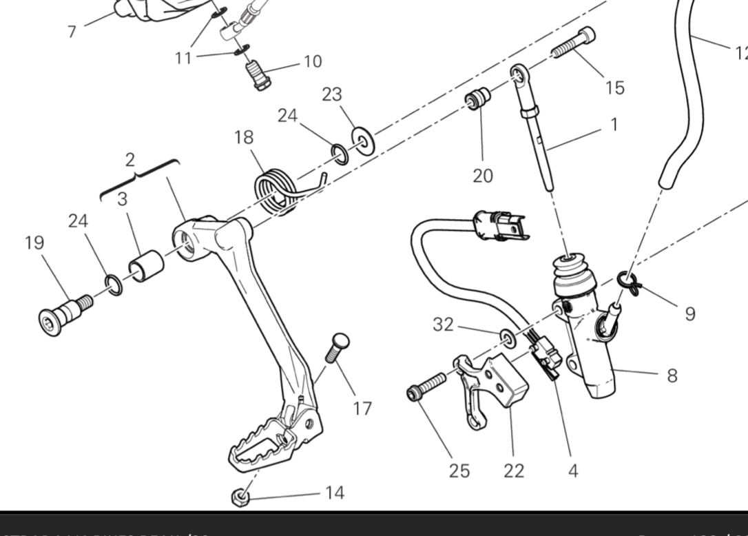

    I took a long hard look at the rear brake lever set up and the brake light microswitch doesn't need much movement of the lever to operate and I also notice the rear brake lever return spring isn’t particularly stiff.
    Pretty confident my boot isn’t snagging the lever which leaves me with the concept, that on uneven road surfaces, the weight of the rear brake lever is sufficient to overcome the return spring and move enough for the microswitch to operate.

  7. It’s an off the shelf microswitch which looks very similar to the switch on the front brake. The way the switch is mounted to the footrest bracket, gives no adjustment to when it operates. The bolt #17 just adjusts the height of the brake lever, keeping the distance the top of the bolt has to travel to operate the switch, constant. I think I might change the return spring #18 in the hope it will be stiffer. Andy

  15. Could be wrong, but I think bolt doesn’t affect the position of the pedal, not to any great extent anyway.
    Its height however, does change the point at which the microswitch activates. Mine needed adjusting when I changed the pedal to a Ducabike version.
    It’s worth checking how easily the light activates by applying some pressure to the pedal. It’s pretty easy to adjust, just undo the locknut (14) and reposition.

  17. Part#4 on the diagram I posted, is described as “switch, rear brake” and if remove the switch from its bracket, manual operation of the switch, turns the brake light on/off. I see your point about the adaptive cruise though, fortunately, it’s a function I don’t use :D Andy
