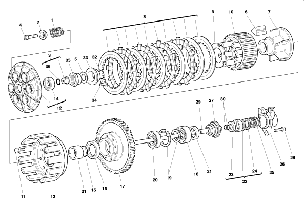

  6. cheers. They look the same height dont they. looking at those pics now reminds me that the 1098 drum didnt have the locating hole for the ...errr... number 33 in this pic. again from memory. i recall there was a reason we mis matched a part but i thought nothing of it at the time[​IMG]

  9. hmmm... that makes sense.. dont know if thats the prob as im sure apart from the spacer? (num 33 in pic) all parts were my 1098 clutch, like a fool when my mate said "do you want to take the old bits with you" i said skip em... doh

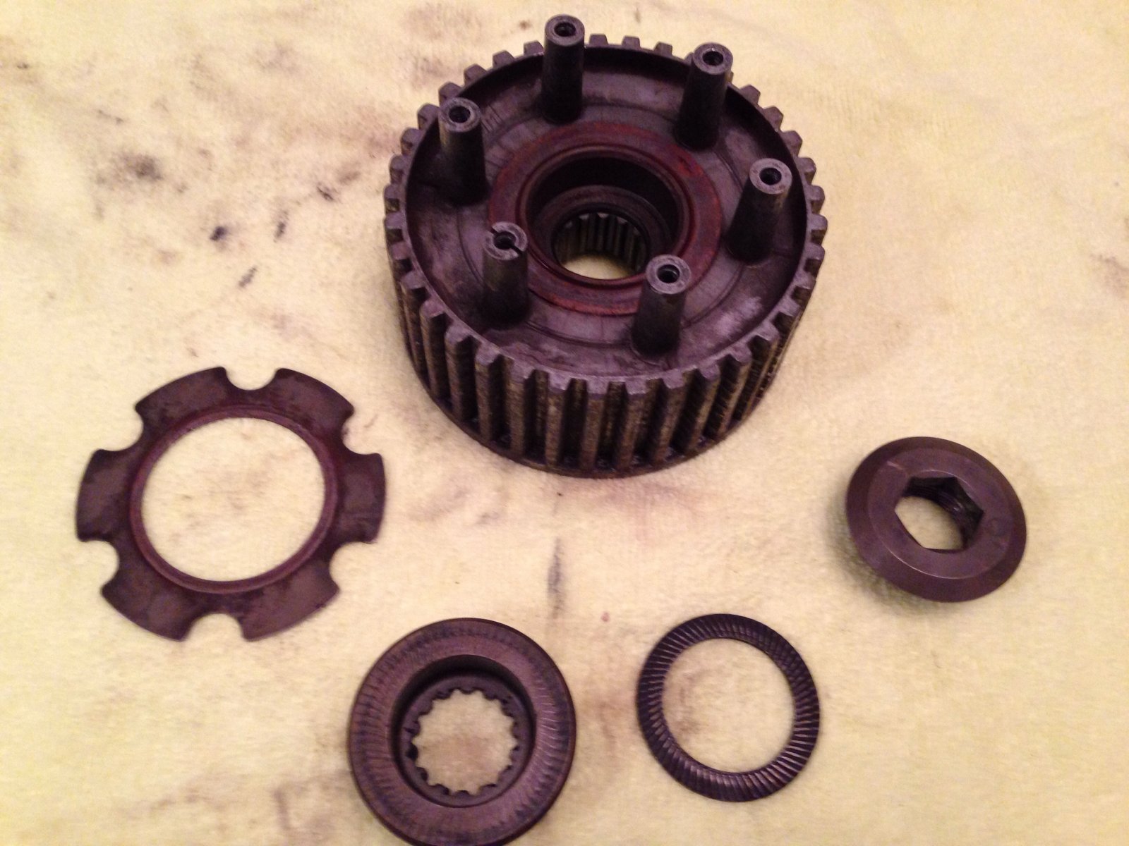

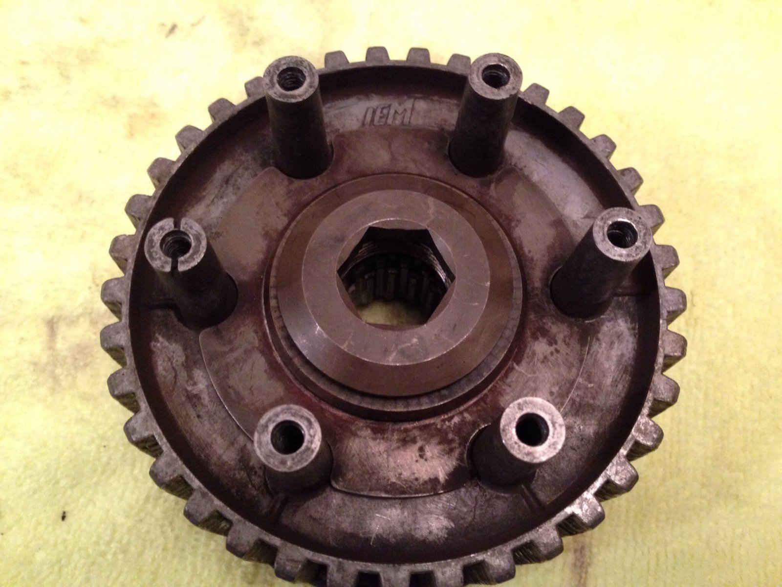

  17. Yeah theres a few differences I've got a 1098 one in bits (drum & PP) let me know if you need any measurements
  18. Hi tobytyke, you got a pic of the pressure plate from the side, plus how long are the springs?

  19. Have you fitted the o ring (No 15)in the spacer that goes onto the main shaft?
