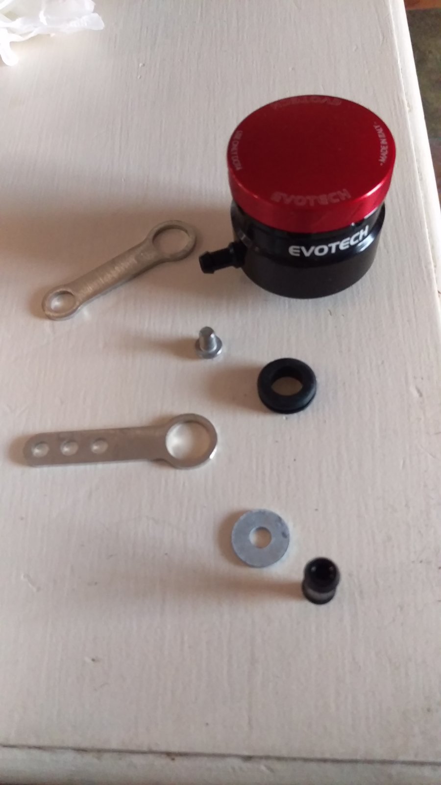

  1. Remote brake fluid reservoir for '03 999? Just got this from Italy, no instructions or anything included.
  2. You need a bit of pipe.
    Remove existing "coffin" reservoir.
    Plug pipe that you haven't got to connector
    Install remote reservoir to pipe that you haven't got
    Fill with fluid
    Bleed.

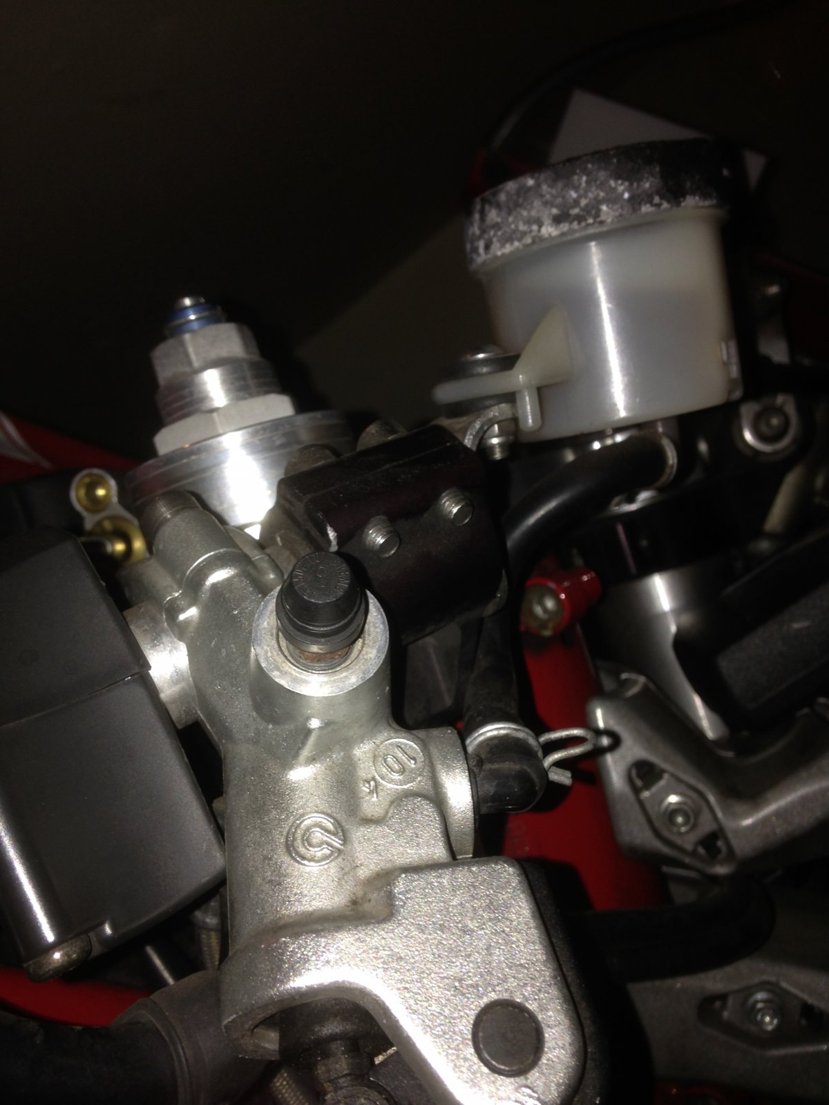

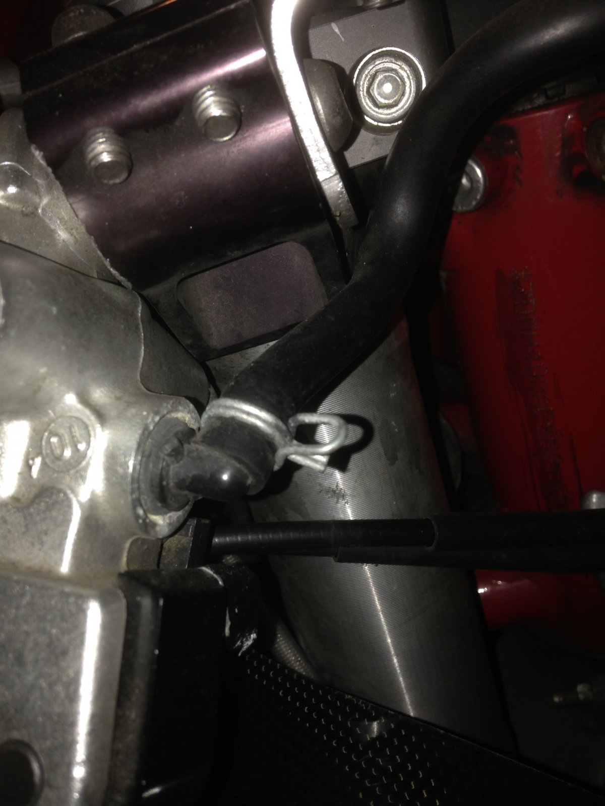

  3. I have remotes on my 999. Part of a kit that came with cyclecat raised clipons.
    Undo the bleed nipple in the coffin to remove.
    You need a push in elbow that you havent got as well. They are a brembo part. image.jpeg
    #3 900streetfighter, Jun 2, 2016
  4. Maybe the remote spigot goes straight in master? No elbow or hose required. If spigot has groove for O ring give it a try.

  6. Oh yes...forgot about the elbow that is also needed.
    I think I got mine from biketorqueracing.
    • Nuke Post Nuke Post x 1
  7. Have a look at the universal Rizoma tanks in their pdf catalogue that you can download. Shows you several types of adaptions and mounting solutions. Rizoma is the closest I could find to the Evotech as the Evotech web site is rubbish. Andy
