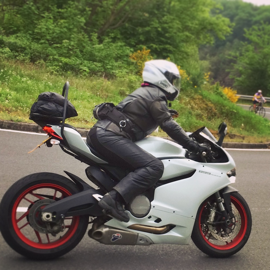

  5. Thanks for the reply's guys, sounds like that's what I'll go for
    This is the sort of thing I'm thinking about :-
    I have 2 waterproof bags that will fit on the back perfect, so I'll give them a try.
