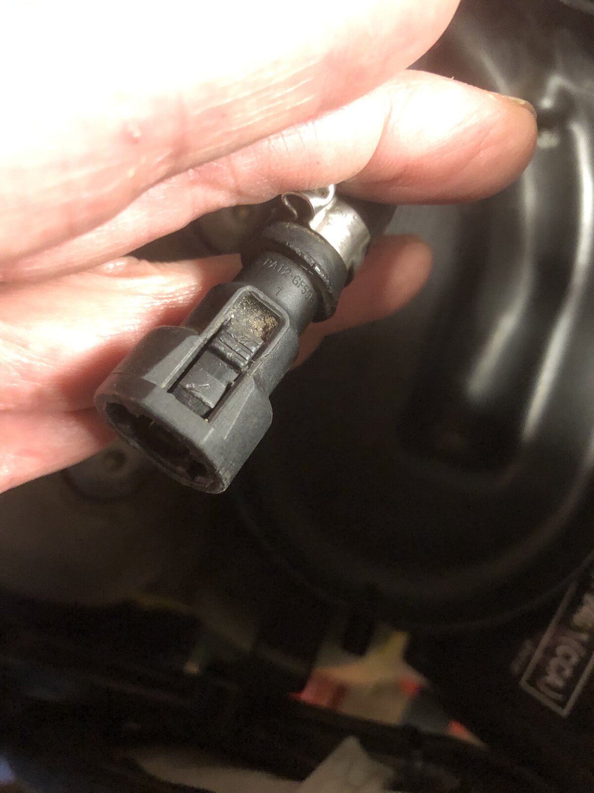

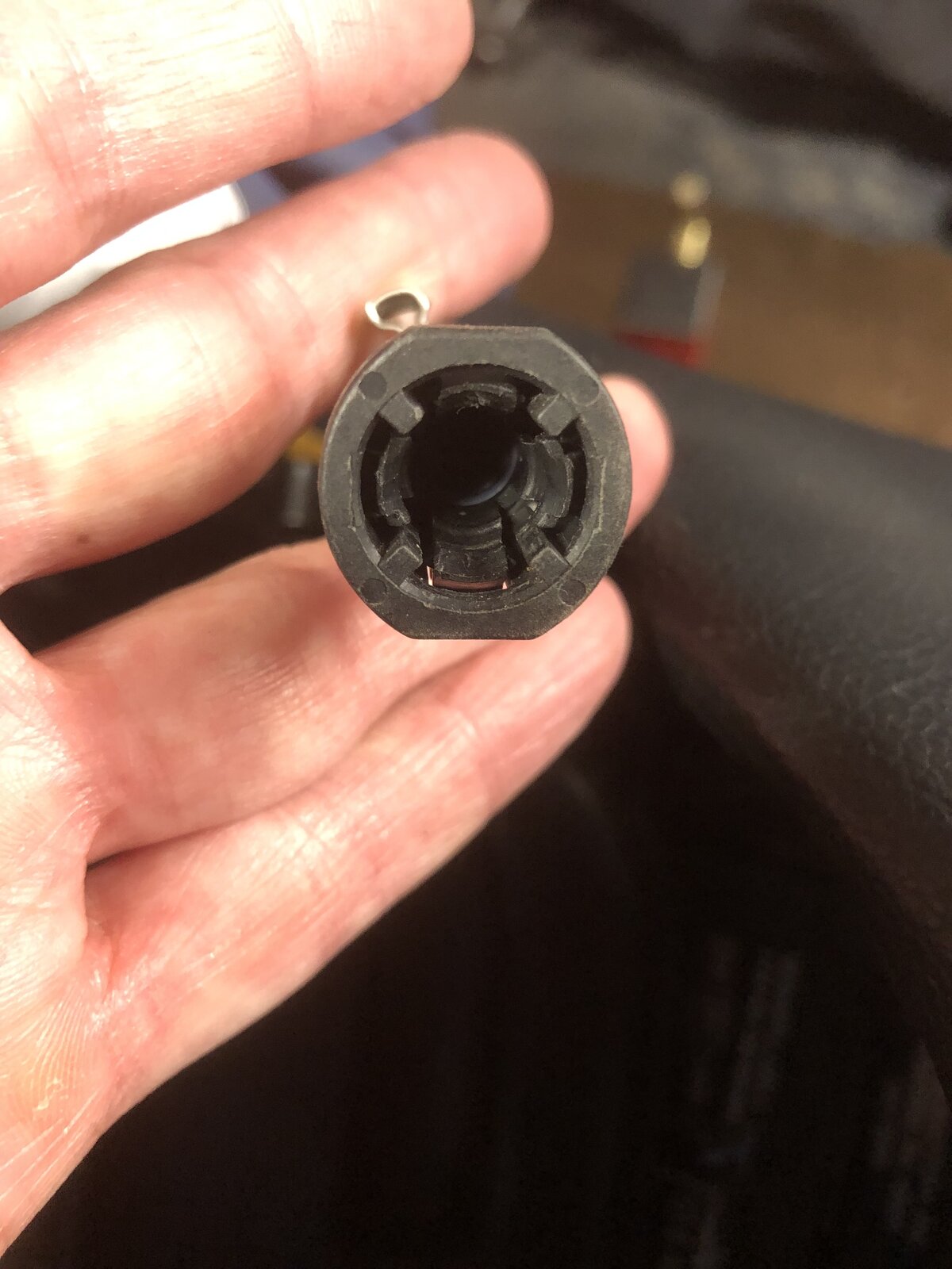

I need to replace the tank to throttle bodies hose as it is showing age related cracking. The end to the tank was tricky to disengage, desipte being accessible from all around. The end that goes in through the side of the airbox and up and under to the throttle bodies is almost impossible to get more than two finger-tips onto it Any suggestions as to how to persuade it to come off will be appreciated, but I dont really want to remove the throttle bodies.
Try something like the following link? I have a small pair for Triumph fuel hoses which are an absolute pig to get off without. These are merely for reference. Google fuel clip pliers for some that would be suitable. https://www.ebay.co.uk/itm/26646439...luQgXR_RVK&var=&widget_ver=artemis&media=COPY
