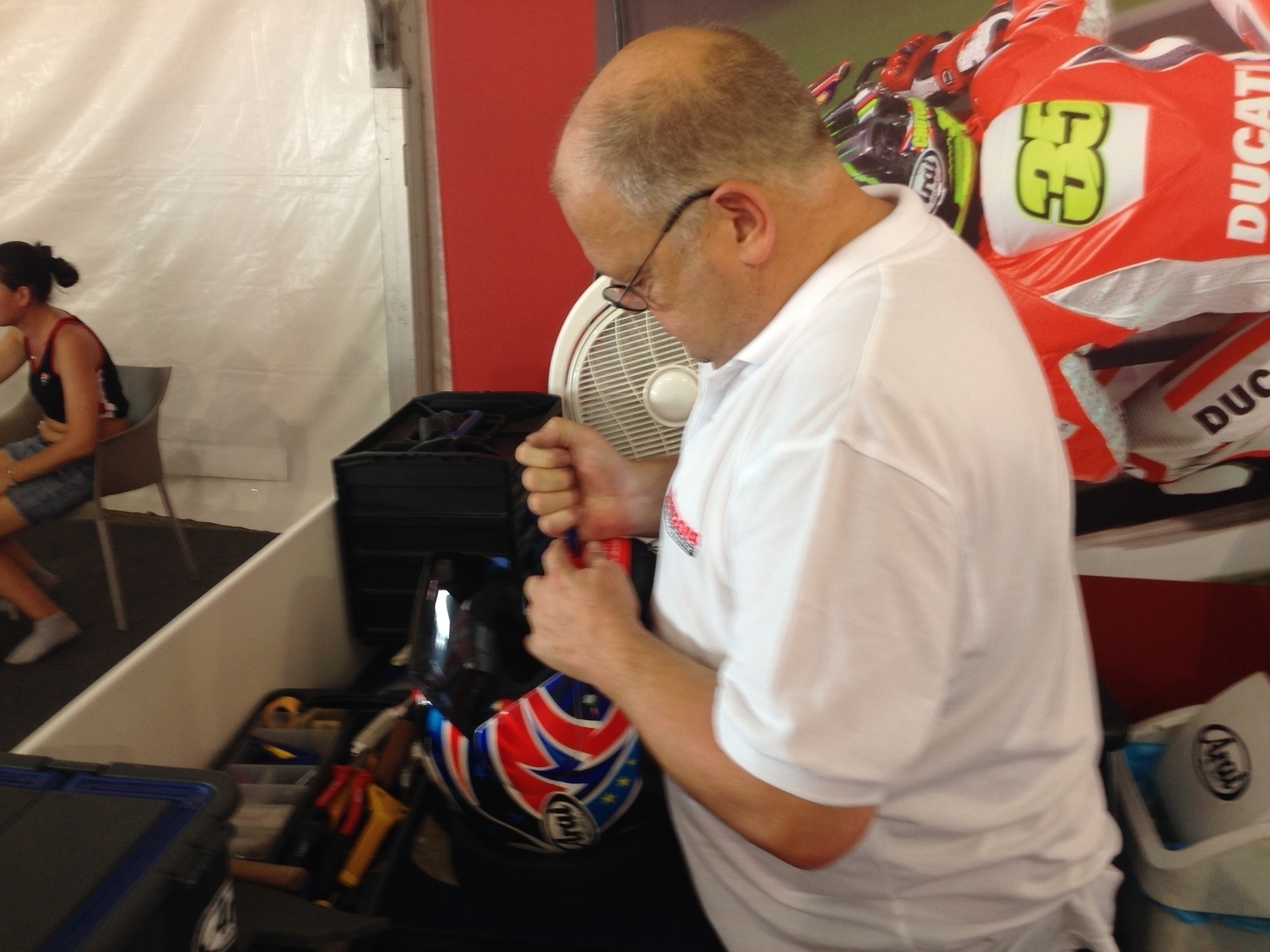

  13. Had mine replaced at WDW free of charge, even though my Astro-R is probably 6 or 7 years old now.
    This was done at the service stand run by Arai Europe, the same guys that are often at shows and bike meetings.
    He used a plastic pry tool to remove the original part, and quite a bit of force, but the new one just pushed back in.
    Have a look at the new part when it arrives as I expect it will help you figure out how it is held in place.
