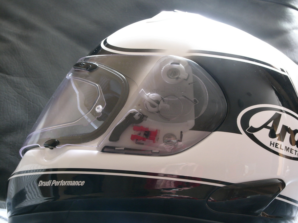

  1. Bust one of the sidepods on my Arai GT Viper. As far as I can see a lot of the Ariai range use the same type , the type for the Viper are J type.
    Anyway could not get a matching side pod for the helmet, probably too old. So I opted for the smoked type from Sportsbike Shop off the web, about £7 cheaper than matching solid colored types.
    These are really good as on my helmet the design is carried through under the pod up to the visor mechanism so they don't look particularly odd. The big advantage is you can see whats happening when fitting the pod or taking the visor on or off.
    This was a really handy as the latch mechanism which retains the pod was sticking and preventing the pod securing, you'd never have seen this with a solid colored pod. I eventually got them seated by pressing hard on the pod and pulling the catch forward with a small long nose pliers. If I'd got the solid color there is more than a good chance I'd either have broken the pod fitting it or worse thought it was secure only to have the pod and one side of the visor fly off when on the bike.

    Here is a picture of the tinted sidepod

    Quite like that smoked pod. Looks good. :upyeah:

    I'd moved the pic but here it is again, not the best photo in the world
    Sportsbike Shop still have them but £20 for 2 bits of crappy plastic really is taking the piss but what can you do if your in that situation
    John
  14. I was thinking of a solid black if I can't get the right one next time, but that looks just fine John. And. Like you said you can see what's going on. Hopefully mine will last until I can afford to change my helmet!
