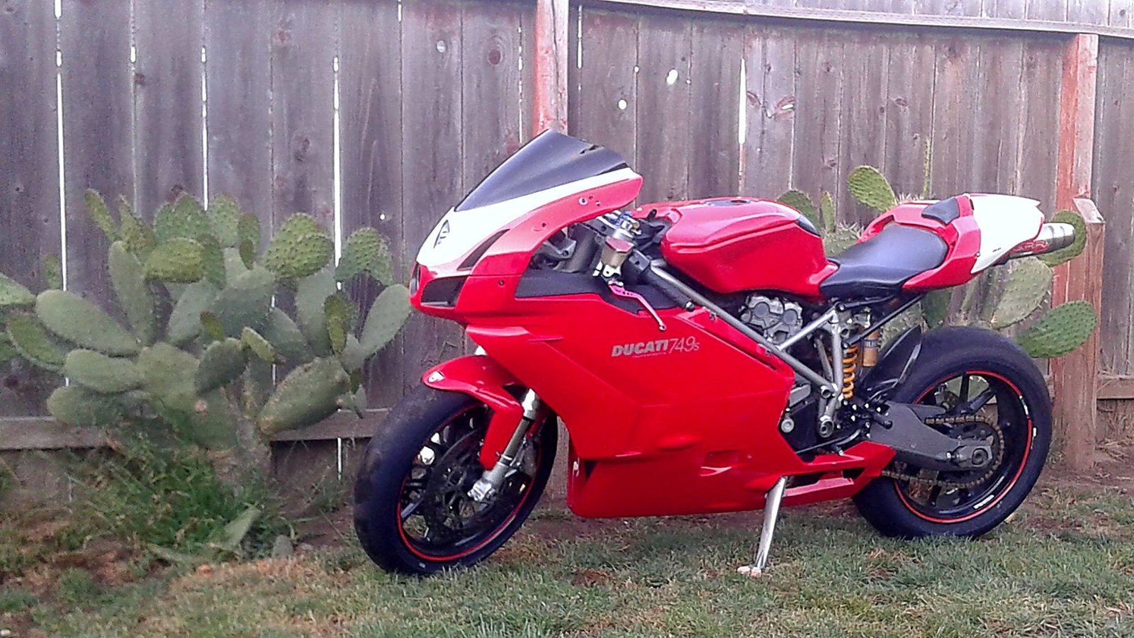

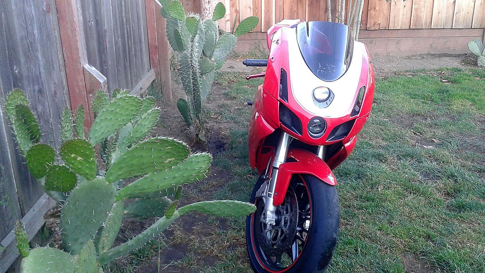

  5. As stated the mirror stays are different since the later fairing is slightly wider. The early side fairings are not a perfect match with a facelift nose but they don't look completely horrible either. The nose in the pic is off an early R but the dimensions are the same as the plastic facelift one.
