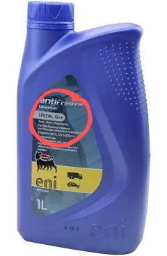

  3. Having looked into it into a bit more detail the agip/eni speziale is VW spec G12++.
    It can be mixed with G12 or G12+ coolant.
    There are lots of G12++ coolants on the market. If you were to use G12+ instead, they are a lot cheaper as well. download~2.jpg
  4. Thanks - that seems to be the equivalent, and all hugely cheaper than buying AGIP in 1l bottles from Ducati dealers
