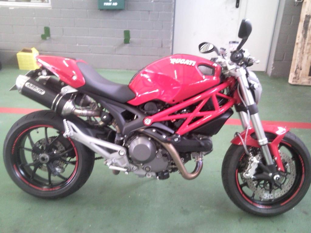

  8. DucAngel I'm away working at the moment so this is the best pic I have with me, hope it helps
  9. Alf Wow!! they look good, as good as the full carbon, i now have a real dilema, which ones to go for, i'm trying to visualise the dark line against my white panels, and i think they would look awesome, i have seen the full ally ones on an 848 they looked good too, why oh why did i ask for pictures??, lol.

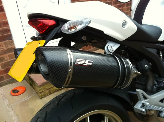

  10. Sc project is worth a look before you buy.

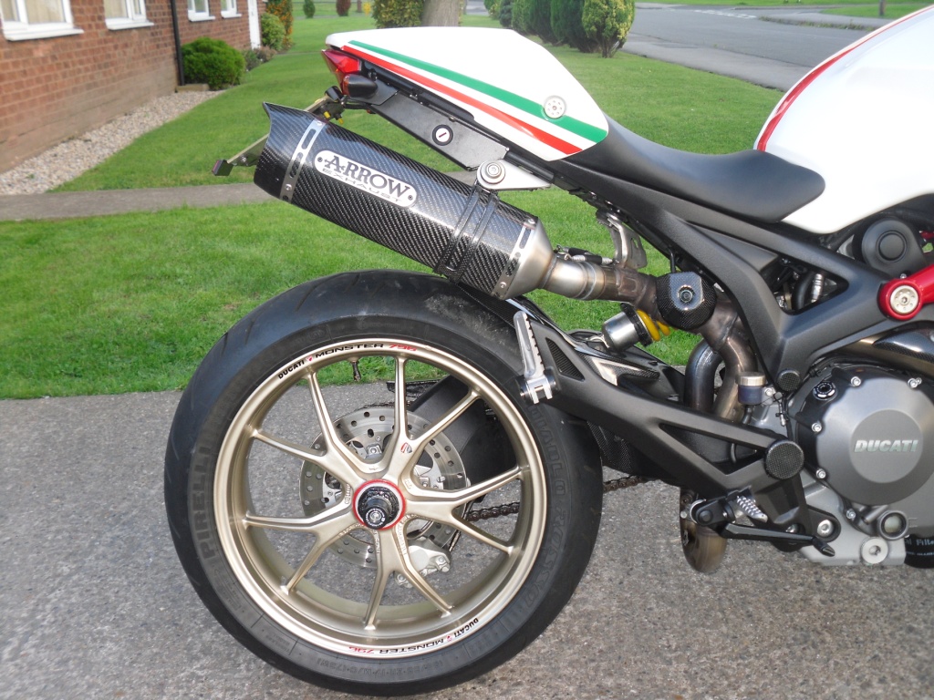

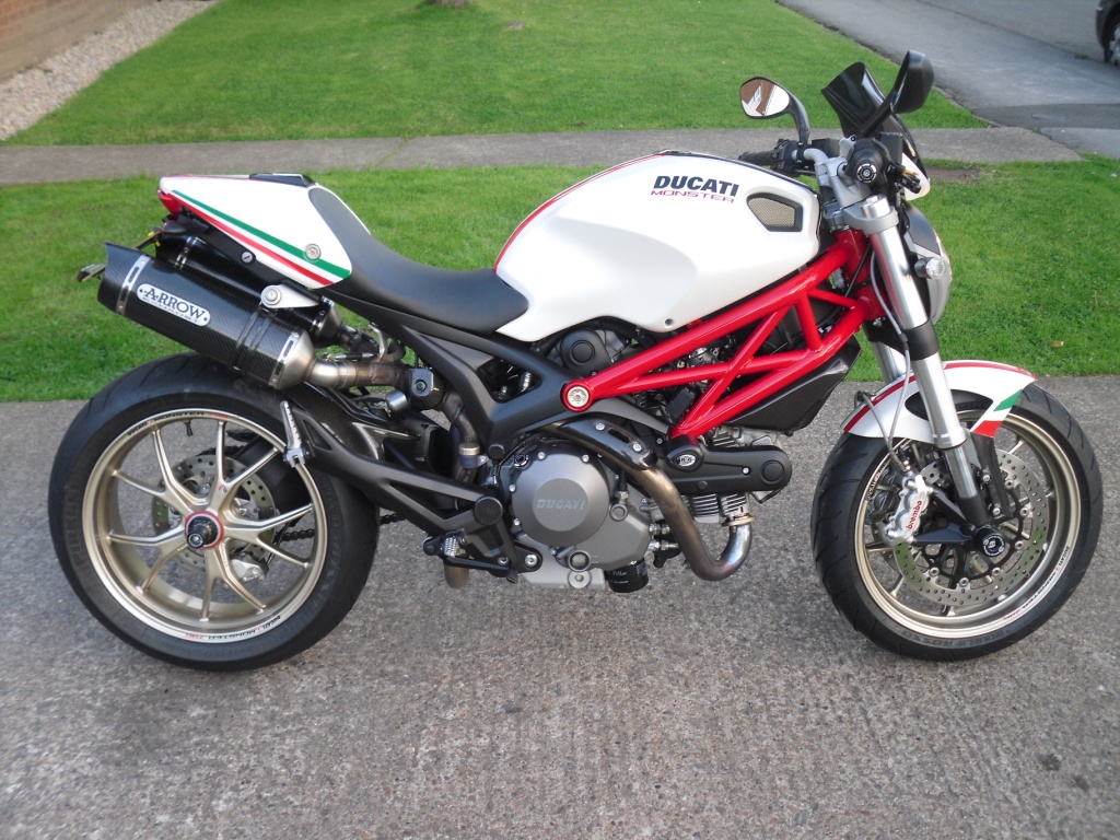

  11. Got them at last, fit good, sound awesome, but need to re-size number plate and i have the yellow /blue logo to go on, not keen on the new style silver / black.
  12. looking good, hope you enjoy them
