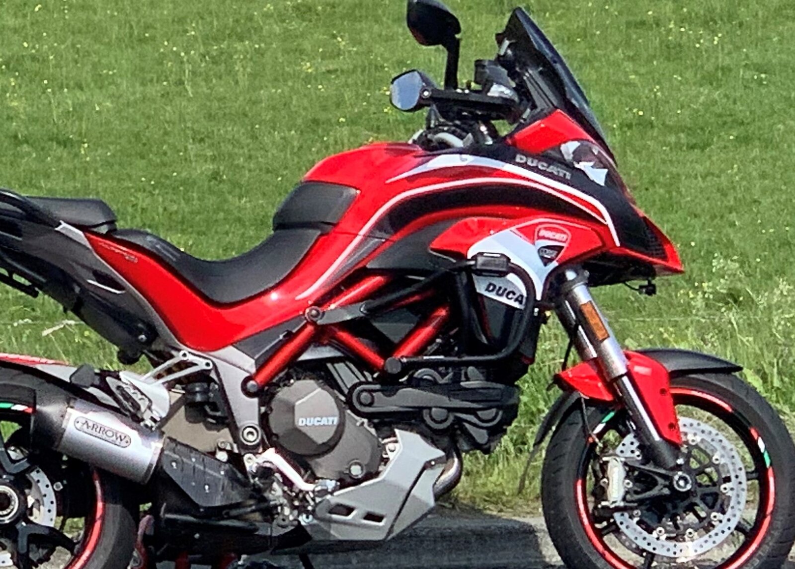

  4. I had a full Arrow system on my 1200 DVT and it was awesome. Impressed me and my friends with a really great sound. No idea if it was more powerful but that doesn't really matter as there's plenty in a DVT anyway. And no remap required.
  5. Cheers, I was doing it purely for the looks and a Termi is out of my reach whilst I save up for a V4.
  6. Arrow great can. Nice looks. Sounds far better. And not 4k for a system ;)
    No need to map ime. Keep baffle in as it’s too loud for long rides otherwise
  7. I have an Arrow slip on, on my 1200. Its loud enough without being a nuisance. Fits easy, no mapping needed. Looks OK.
  8. First thing I did on my 1260s was put the arrow and decat pipe on. It's very well made, much better value than the termi and doesn't (officially) need remapping. Lots of pops on decel and bangs on aggressive upshifts which I guess could be tuned out, but I like them (and the flames). I think the pops were there before they were just buried in the cat
