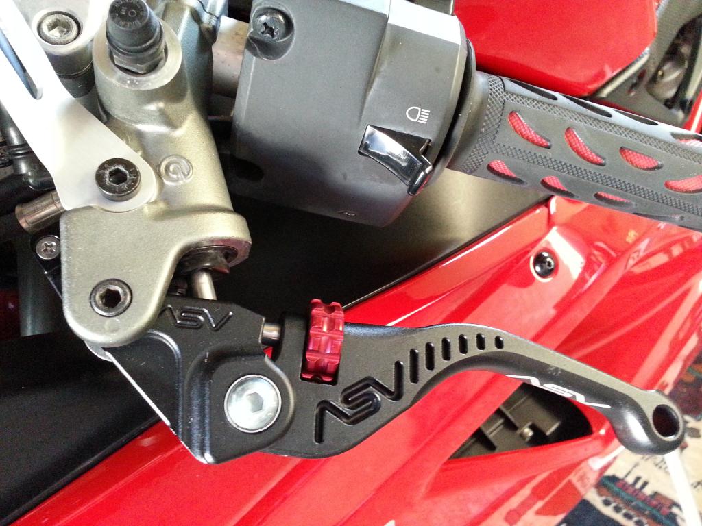

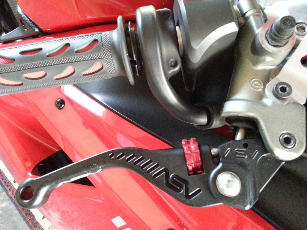

  7. Here is some pictures of the levers I have now fitted on my 1098 which are exactly the same as the ones I sold but in black. 20130605_183742.jpg 20130605_183807.jpg Can anyone confirm that they would fit the 848/1098 Streetfighter?
  8. Well they're the same as mine and fit my 848. Bet the twat hasn't even tried fitting them.

  10. Just looked at an ASV catalogue and both the Yam and Duc part numbers are BRC550, so don't know where your buyer's getting his info from.
    I can't find any mention of BCR50B, my guess would be that BRC50B is just the part number of the lever itself without the pivot and other gubins. Did Google it and this came up:
    "I put ASV C/5 clutch and brake levers (long version) on my '09 1198. The sheets in the boxes show the 1198 base/S/R uses the same levers as the '08/'09 848. There are lots of little pieces required to fit the Ducs.
    Brake:
    On the same sheet it says to remove the stock push shaft and replace it with the ASV push shaft. The little bag the shaft came in calls it the BRC50 Pushrod - Shaft. You'll also need the BRC50 "D" Bushings (top & bottom bushings for the pivot screw), BRC50 Brake Tab "D" (actuates the switch) and and BRC50 Brake Tab Screw. All the brake stuff is labeled BRC50-x.
    Clutch:
    For the clutch the push lever is called the CRC550 Pushrod - Shaft "D". There's also CRC550 "D" Bushings (top & bottom bushings for the pivot screw),CRC50 Tab - Stop Block "D" (actuates the switch) and CRC50 Clutch Tab - Stop Block Screw. Half the clutch stuff is CRC550-x and other half is CRC50-x"
    [FONT=helvetica, arial, sans-serif]I reckon he's made an honest mistake by looking at the number on the lever itself which seems to be irrelevant in the nicest possible way tell him they are the right ones and he's been an idiot [/FONT]:wink:
