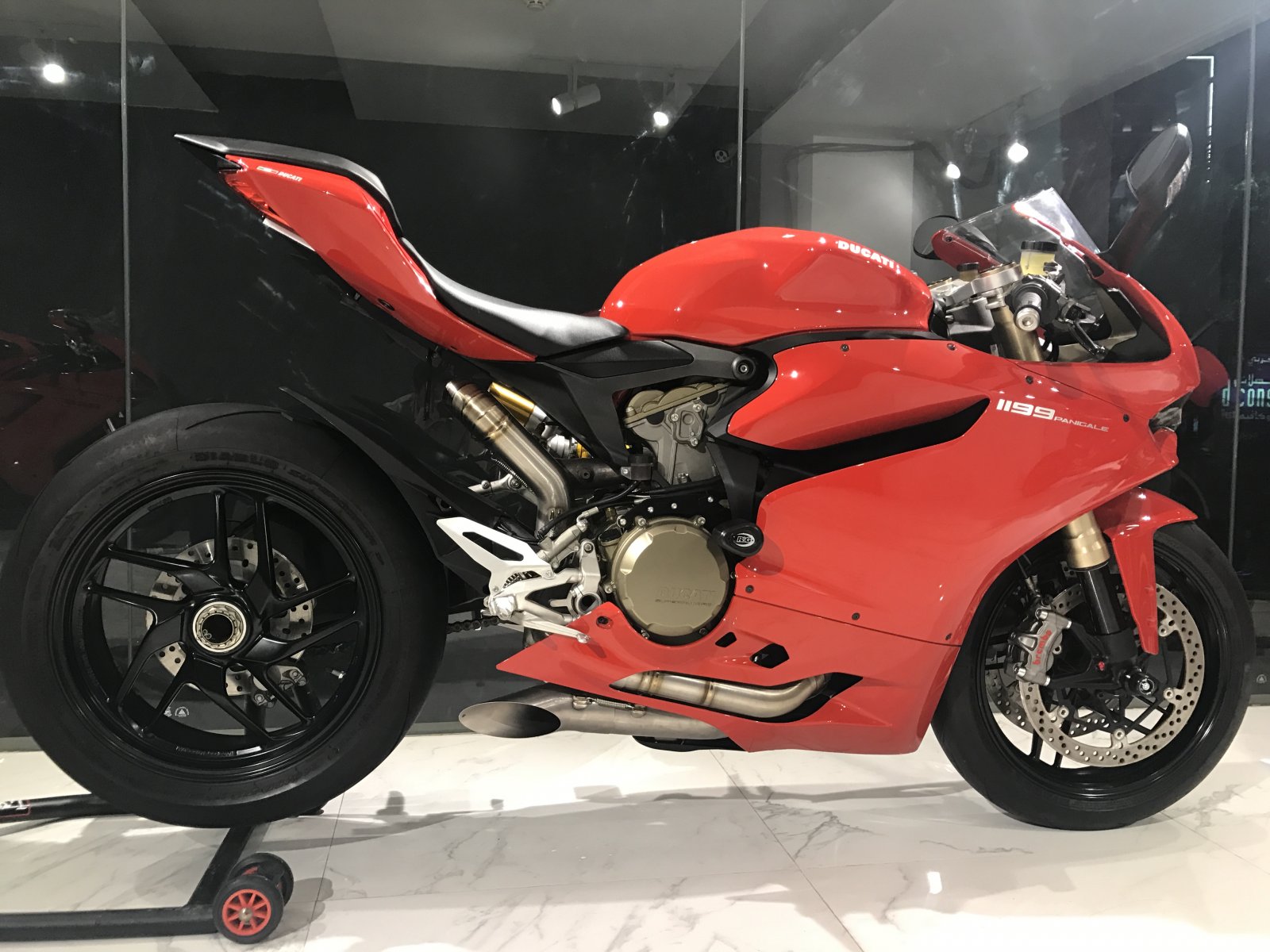

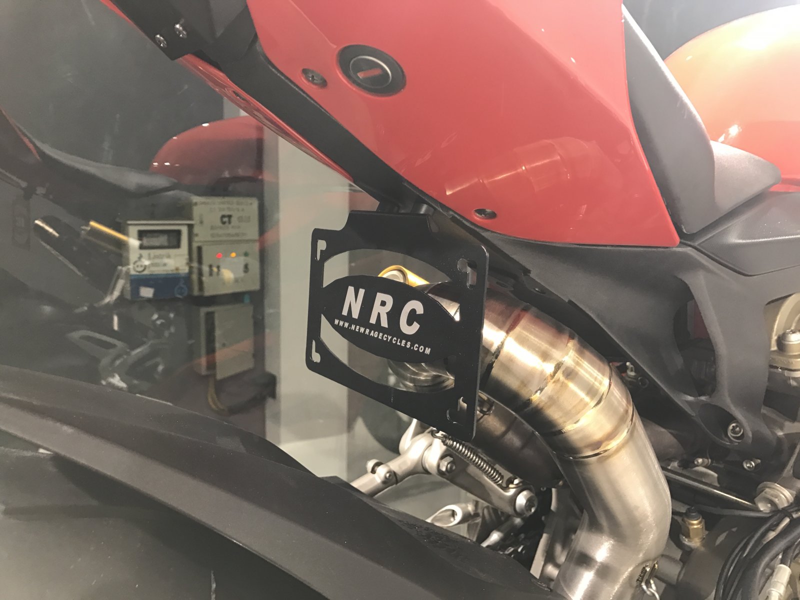

  1. I've just install an Austin racing GP2 FS.
    I'm not tested yet on the road but the sounds is pretty loud and I'm not using DB killers at all.
    I want to ask a few question, is this exhaust will burn my under fairing and license plate?
    Do I need a customized something to protect my under fairing?
    Thanks before
  2. that looks like its going to be loud!!

  6. Have a AR system on my 1199, never had any problems with the tail section paint in relation to heat. The location of the number plate with the NRC system might get a bit toasty though :)
    But had a problem with the lower right fairing getting burnt where the pipe bends in behind the fairing just below the brake pedal.
  7. Thanks for the info. Did you use aluminum foil heat shield for the lower right fairing?
    Thanks
  8. Had no under seat problems but the lower right fairing is a problem as Mordor already said
  9. Had the silver foil on the inside of the fairing, but the clearance between the pipe and the fairing is marginal, so worthwhile to check on the clearance and consider putting a spacer behind the fairing where is is screwed in by the brake pedal to give a millimeter or 2 of added clearance :)
