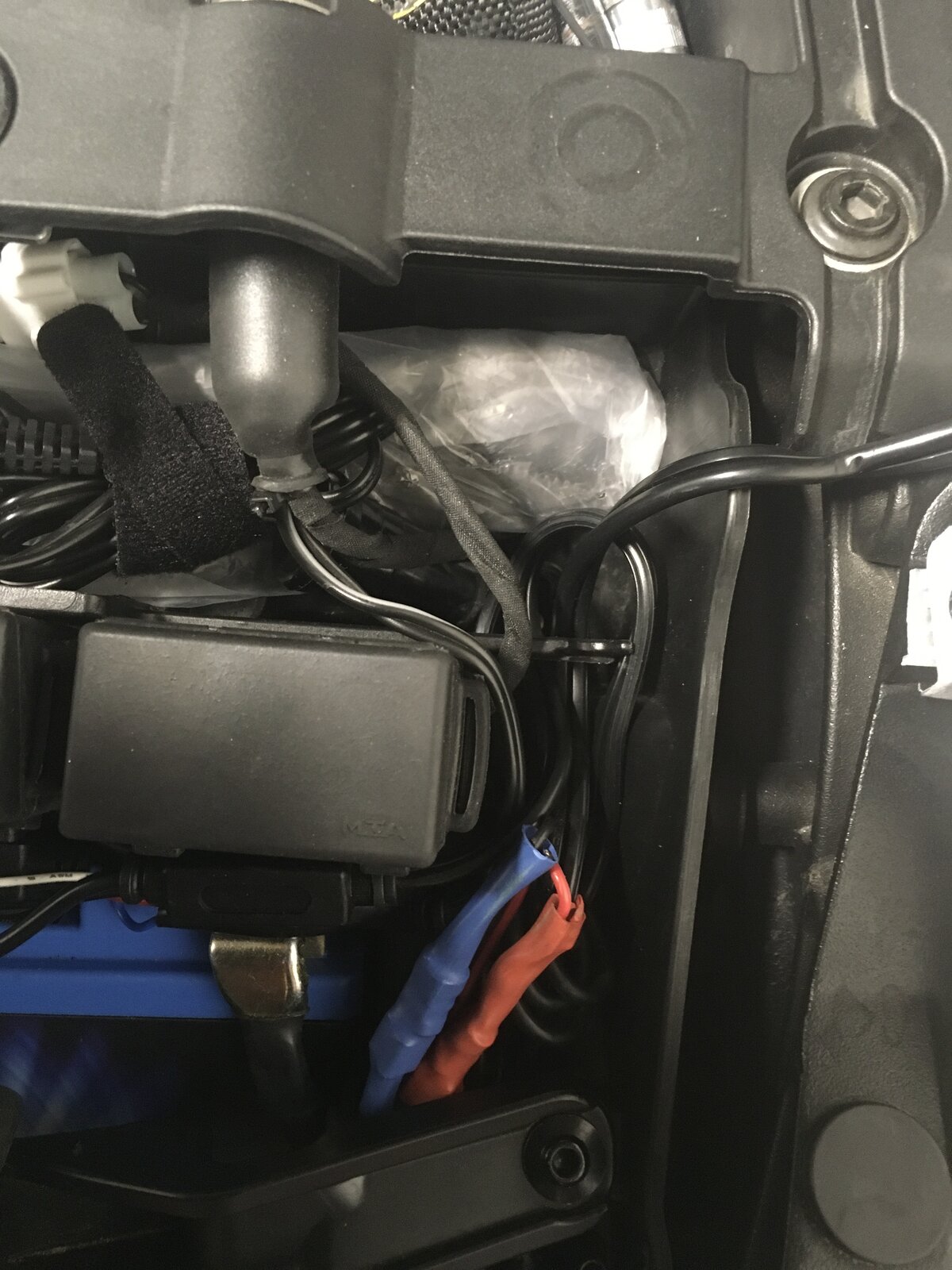

  1. Has anyone fitted an Autocom and where do I find a switched live feed?
  2. I use a starcom. Have done for years. Switched feed for mine is spliced into the wires for the under seat 12v charger. Easy. And it’s already fused.
  3.
  4. Hi, the handbook suggests that this is not a switched supply, is that wrong?
  5. Fused and switched. 100% certain.
  6. Great! Thanks for the info. I'll be busy this weekend then.
  7. There you go, disconnected from battery side of the compartment splice in and job done.
  8. Pleasure. That’s what the forums for :upyeah:
