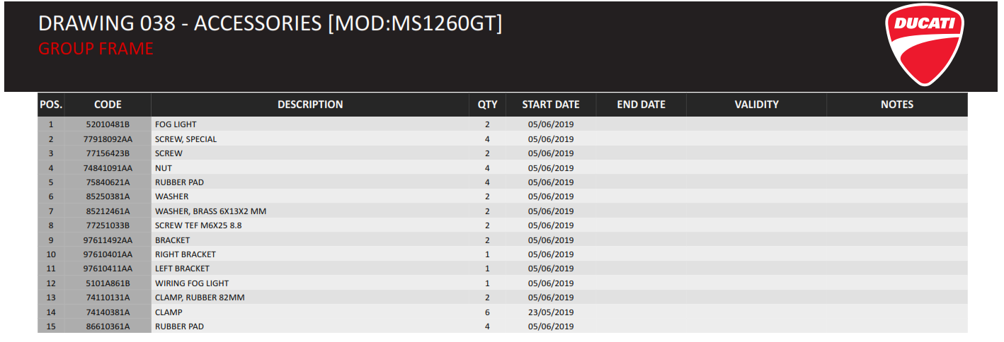

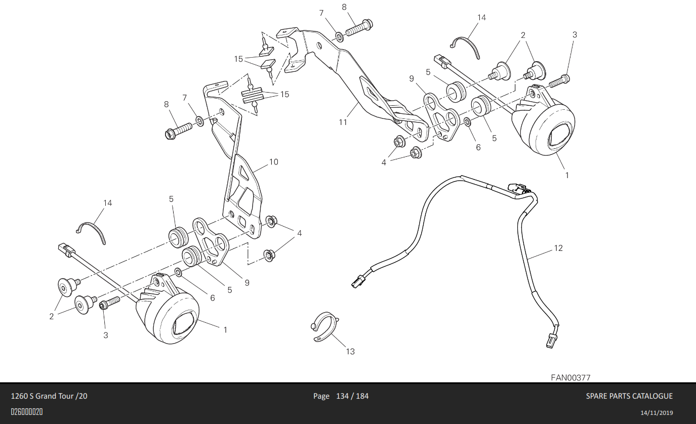

    Does anyone know the part number of the extension harness needed to add in a pair of OEM spotlights on a DVT?
    I have read its available as a separate part, but cannot find it on a fiche (likely not hitting the correct combination of words?)
    It'd be the one that feeds from the 3 pin connector on the bike and has a connector to each spotlight.
    I am fitting a set of touratech crash bars, and although I dont have the lights yet, it'd be easier to get the wiring in place while the plastics are off.
    Thanks for any help :)

  3. Awesome !! Thankyou very much. I looked high and low for those :)
