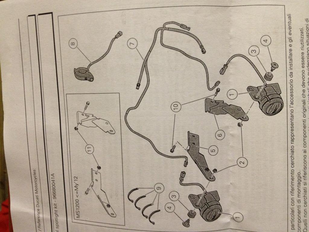

    Tony, these are what I fitted, they are Ducati fitment, I looked into other lights i.e VisionX but by the time you buy the lights, switch etc it was easier to buy the Kit from Snell's, they are the same lights as the GT I wired them up myself, and it took a couple of hours, power is taken from the Sat-nav feed, and if your running sta-nav that piggybacks into the new loom, , if I did it again it would take half the time, I don't know what your hoping for ie more long range or foreground, I like them as they also give more presence to others
