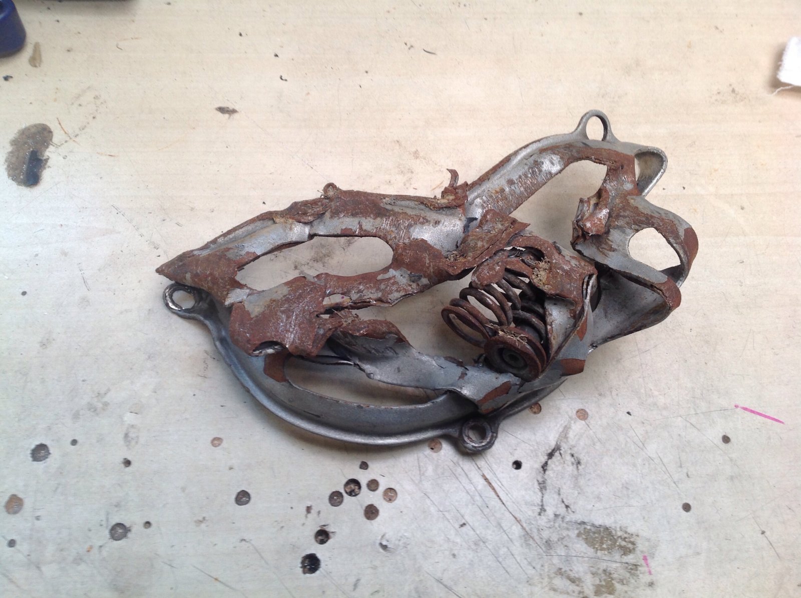

  6. My genuine RS steel clutch cover after a "slide" at Clearways....
  7. Which side did you slide on? Clutch side? :Bag:
    Whoa! Just askin' like!
    Avanti/Antonye is a good sort and I am happy to deal with him on occasion :upyeah:
  8. I wasn't watching at the time...my face was planted on the surface of the track sliding along at a fair rate of knots!
    However, had I taken the time to investigate the dynamics of the crash in slow-mo, I reckon you are completely correct!
    I had standard clutch pressure plate with springs sticking out just waiting for it!
    Cheers.
