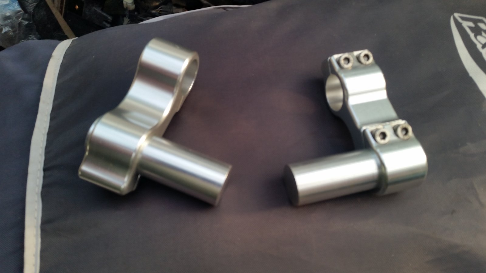

  1. Has anyone used these bar risers before ? 2017-08-25 18.46.29.jpg 2017-08-25 20.00.22.jpg
  2. Are they specific to the 748/916 range? I would be surprised if there wasn't a problem with clearance between fluid reservoirs and the fairings.
    Steve
  3. That's what I thought I took a risk buying them . Ran out of time to try and fit tonight .
  4. It'll be interesting to see how you get on.
  5. Haven't seen those but I splashed out on Gilles variobars.
  6. I got a week to go b4 the Southern Rally with DOCGB. I thought I'd take a punt and try these . I can't find any images of them on google .

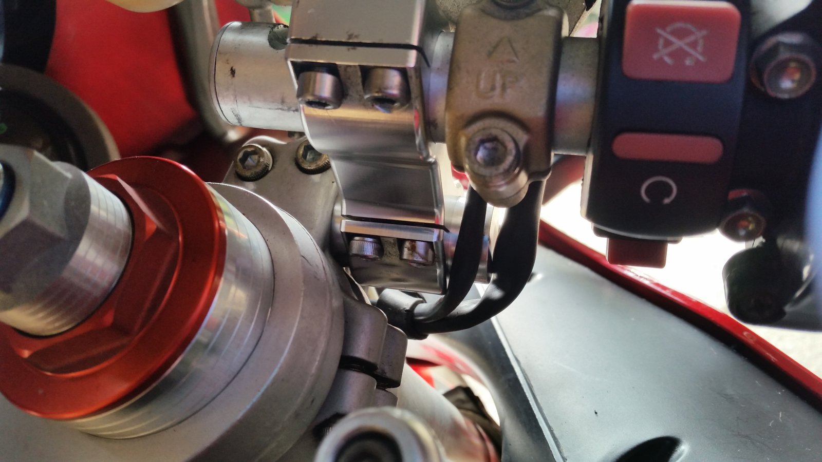

  7. I have bar risers on my bikes and they have a 25mm lift and fit in the stock position on the forks and they just about fit using the switches and master cylinders in the same position as per original. As mentioned it's highly likely you will have clearance problems and if nothing else the master cylinder will start to rub on the screen.
    Mine misses the screen by the merest fraction so anything taller is likely to limit steering movement in my estimation.

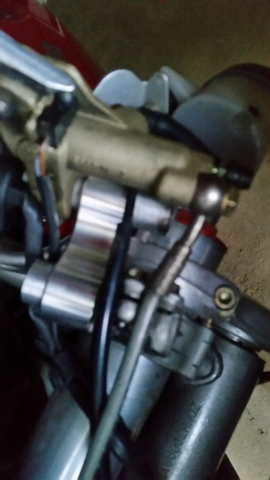

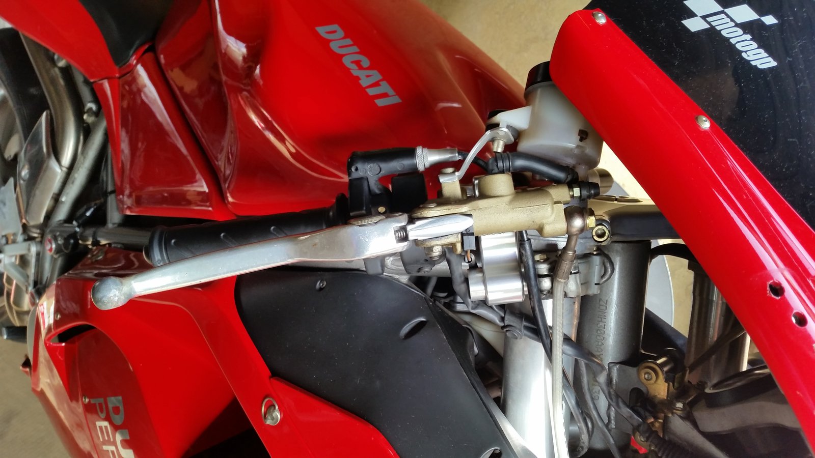

  8. Managed to get the right bar on with just enough clearance on the reservoir, but the speedo cable was too tight on full lock . It didn't look right ,so given up for now .
