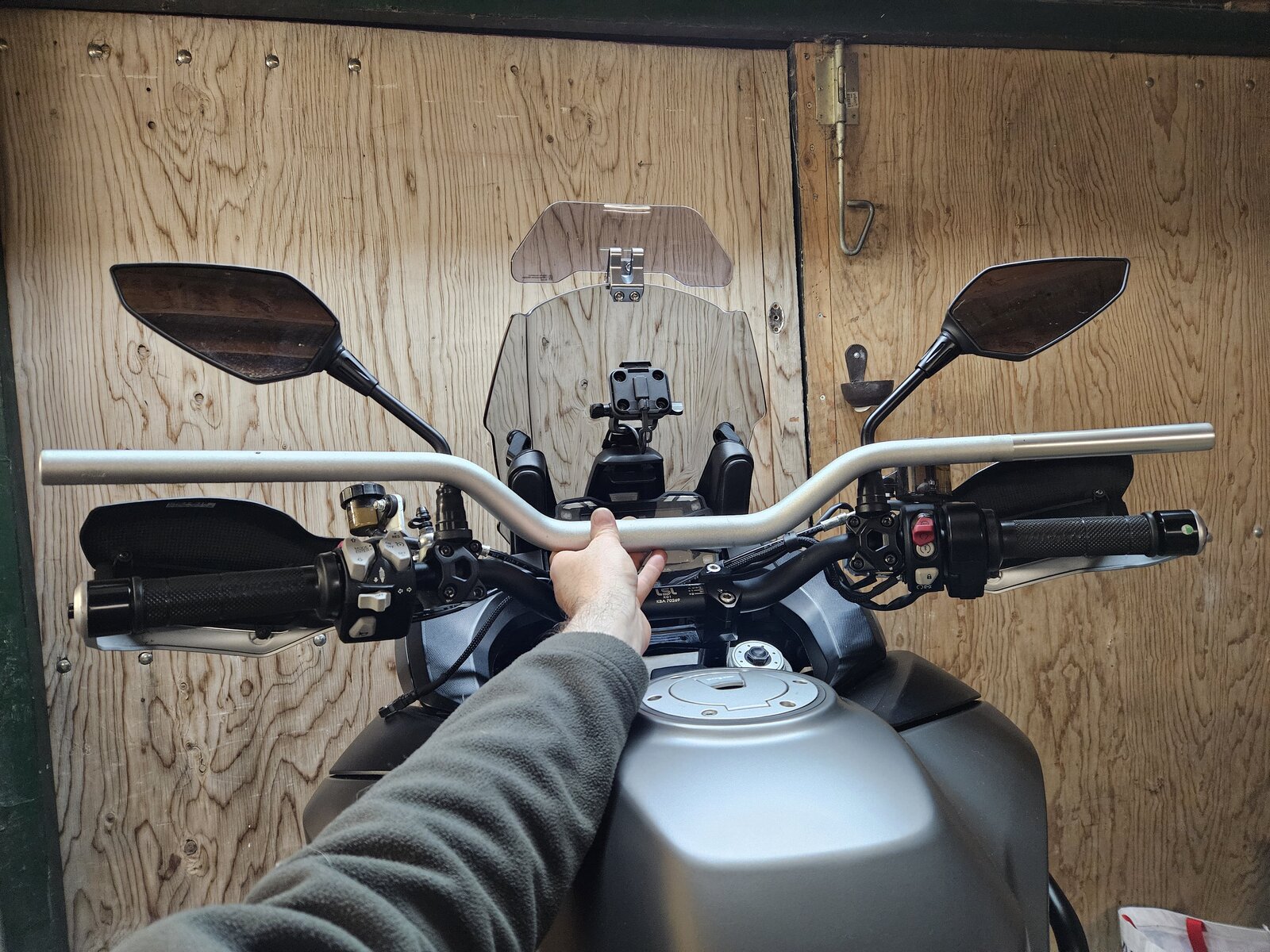

  8. I have just fitted the below handlebars on to my 1260 along with the Gilles riser kit I've had fitted for a while. The combination of these bars and risers without the additional 10mm spacer, with a bit of bar tilt to me, has made a big difference to my shoulder and middle back pain.
    That and the bike feels more stable and I like the feel of these bars in the bends rather than the windsails on from factory.
    https://www.sd-tec.de/en/item-1-705780025.html
    https://www.lsl-online.nl/nl/detail/2071169/superbike-stuur-alu-blauw.htm
