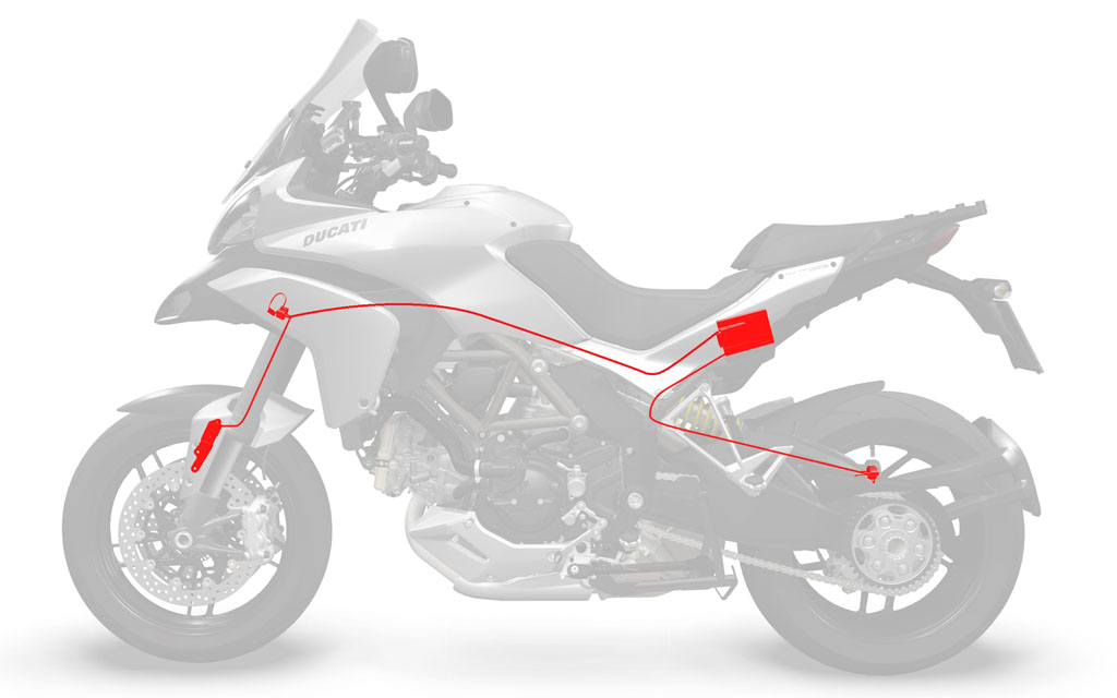

    As a side. If Skyhook constantly adjusts and levels(?) the suspension, what would be the result of dropping the forks 5mm....would Skyhook then try to adjust back up? Just a thought. Maybe I dont understand the mechanics of it.
  7. I'm guessing yes because the sensors would be closer together....but there again what do I know?!
