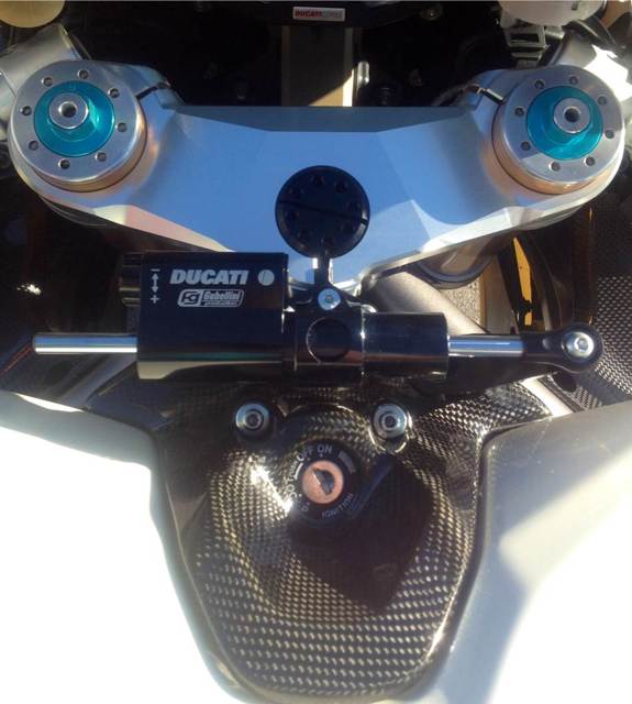

How about mm above the top yoke? I have just above flat at the mo so you can see a glimpse of gold over the yoke. Should it be a ring or two?
Iirc, when I set mine up (originally) to base settings, from the measurements I had, I think it was two rings showing. I think! http://www.ducati.ms/forums/attachm...ohlins-information-fg5110-ducati-1098-oem.pdf What Nelly said.......
Brill, thats exactly what I needed best go and spend another couple of hours, losing finger skin, trying to undo the blasted lower clamp
1098 forks are fitted with 242mm from top edge of lower yoke to top of fork leg. This gives about 2.5 rings above top yoke iirc. 848 is 235.5.......i'd set to that because of the different front geometry etc.
Install height on the 1098 is same for Ohlins as well as Showa. The original 848 forks may well be different though Bradders?? The front ends are different so they could well be. Might be worth a quick measure so you have a base to work from.
Thanks yeah they seem 5mm or so shorter, and most I have seen fitted dont have much above the yoke where showas are a fair bit. I'll set up as the size above and start from there
I have all manor of measurements I took from when I stripped the showa's from mine (top of lower clamp to end of stantion, bottom of lower clamp to wheel spindle centre, static sag etc) at home. I compared those with info from one of the US sites and info supplied by Dan Kyle, and I'm sure I still ended up with two lines showing tho. I was under the impression the 848 only had different geometry at the front, because the rear ride height was higher than the 1098's?
