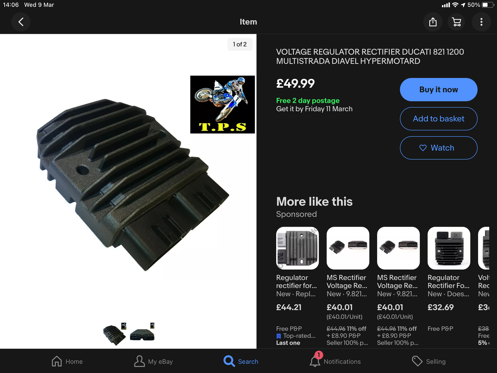

  5. This would do…
    Then you’d just need the Triumph link cable.
  6. I would source a used Reg Rectifier as a lot of the the ‘New’ China made ones are just Shunt ones made with the correct connectors. Triumph are a good source and also the Kawasaki ZX10R.
    Triumph do a wiring harness that allows connection to Ducatis with just the addition of a cable tie to keep one of the connectors held together. The part number is T2500676. These could be had for £10 when we started doing the mod but are now over £20.
    https://www.ebay.co.uk/itm/REGULATO...=p2349624.m2548.l6249&mkrid=710-127635-2958-0
    https://www.ebay.co.uk/itm/Kawasaki...=p2349624.m2548.l6249&mkrid=710-127635-2958-0
