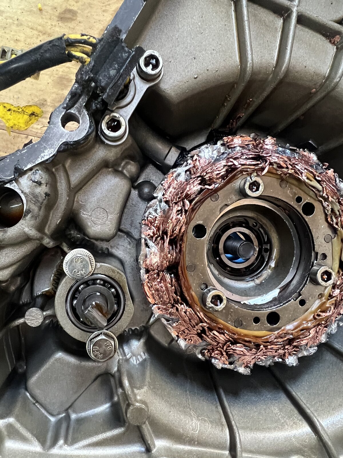

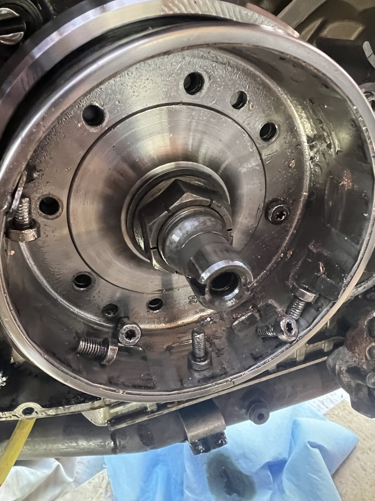

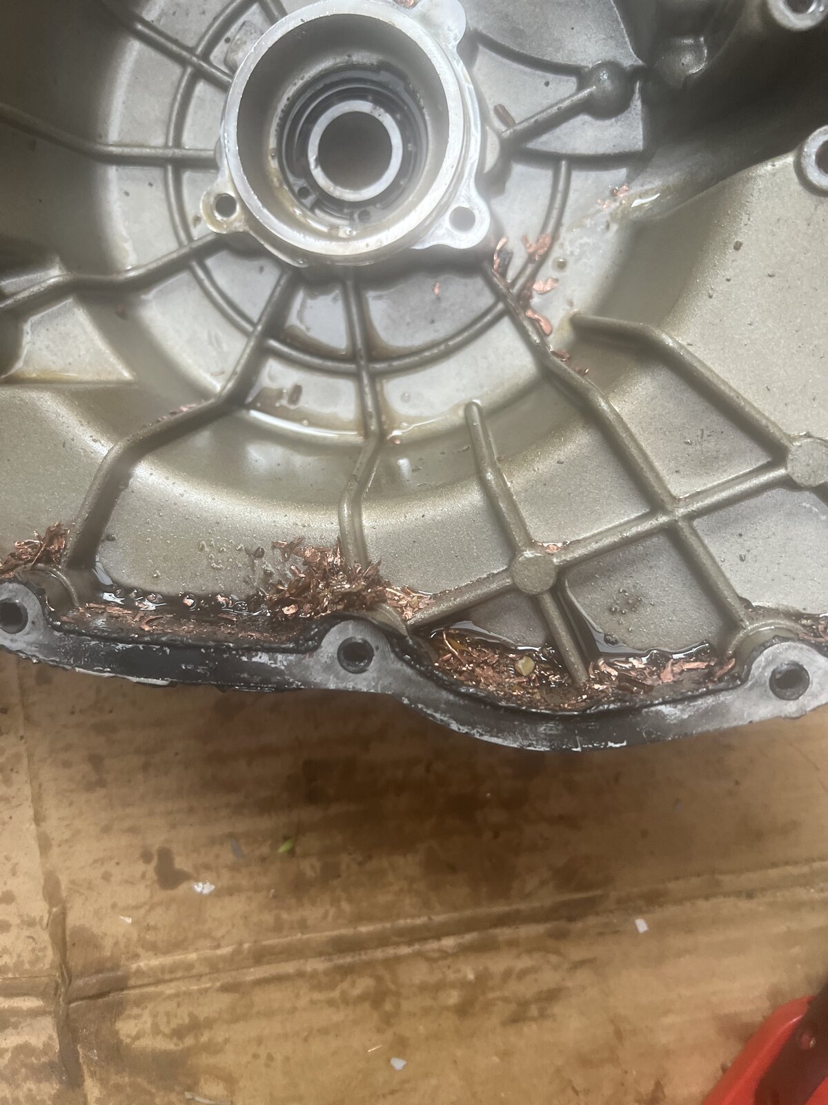

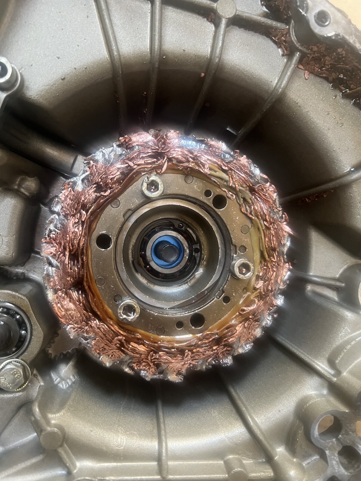

  6. So a little update... Dropped the oil, mad panic an absolute load of copper flakes in it. Read forums omg bearing failure...thought sod it I've got the new stator anyway ill fit it being as I've stripped the fairings off etc., coolant dropped, LH crankcase cover removed, and found the source of the copper. All but 2 of the rotor bolts had come loose/fallen out, rotor had basically destroyed the stator and wobbled around that much had elongated a few of the bolt holes on the rotor. I think as the rotor has a very strong magnet it attracted all the non copper bits too it, and after cutting filter open and dropping the gauze filter could only find copper flakes Thing is what to do now? rebuild flush the oil system and fit new filters and oil, or the same but flush oil cooler and lines or...split the cases completely and tear down rebuild the motor? Ill post some pics of the carnage when i can get them across from my phone.
    I've done just over 300 miles on the bike as I work overseas I've had it over a year now think I've got any comeback with the dealer i got it from? Oh and the bolts (not) holding the Rotor on are too short and have no traces of thread locker on them, disaster waiting to happen!

  8. Oh dear, sorry to hear about your misfortune.
    I would think that new filters and flush the oil would be sufficient rather than split the cases.
    Obviously make sure you have retreived all the swarf and bolts.
    I myself have a recurring thought/worry whether I remembered to loctite the bolts on mine when I installed a new sprag assembly - pretty sure I did but 10% thinks I didn’t!
    Good luck with mending it.

    Been busy ordering new/used stuff to do the repair, I'm up to about £450 with parts and consumables, at least my labor is free! Unfortunately it will have to sit till the new year as I'm back overseas end of next week. Stripped the oil cooler & lines off it, Flushed them through, and also an excuse to give it a clean and a touch up with some rattle can VHT, not much copper came out so I am hoping the gauze/spin off filter collected the most of the copper.. Ordered some flushing additive as well and some cheaper engine oil to flush it through with, and a jumbo tube of Thread locker!!!!
