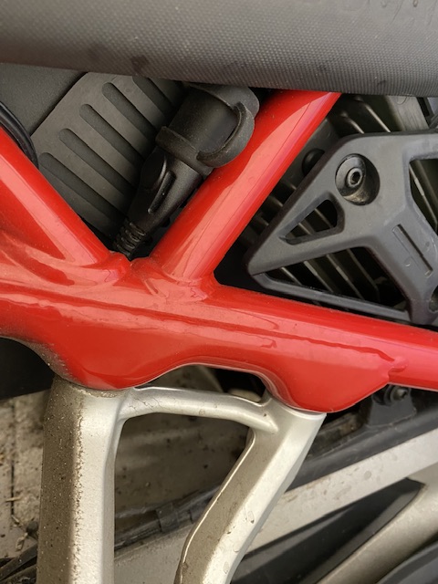

  4. You have to either have the Ducati charger which plugs into the diagnostic port under the rider’s seat, or, what most do, is fit the fly lead for an Optimate/ctek/Noco/whatever your choice is direct to the battery and run it under the frame and outside. It saves taking the seat off each time (which if you have heated seats involves constant unplugging/plugging in. The flylead fits neatly into the triangle of trellis frame just behind the reg/rec, on the RH side, below the seat.
