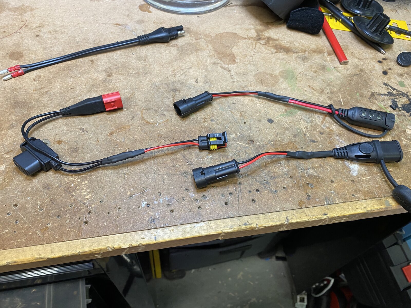

    Check the list of compatible bikes I understand this works with all Euro5 bikes, I bout it for the 1260s diavel, I cut off the optimate soldered a a standard 2 pin waterproof bike connector on and then made up a 2 pin lead for Ctek and optimate can plug either in and use what you like, I charge with the Ctek and use the optimate2 lead for such as my heated vest (max of 7A)
