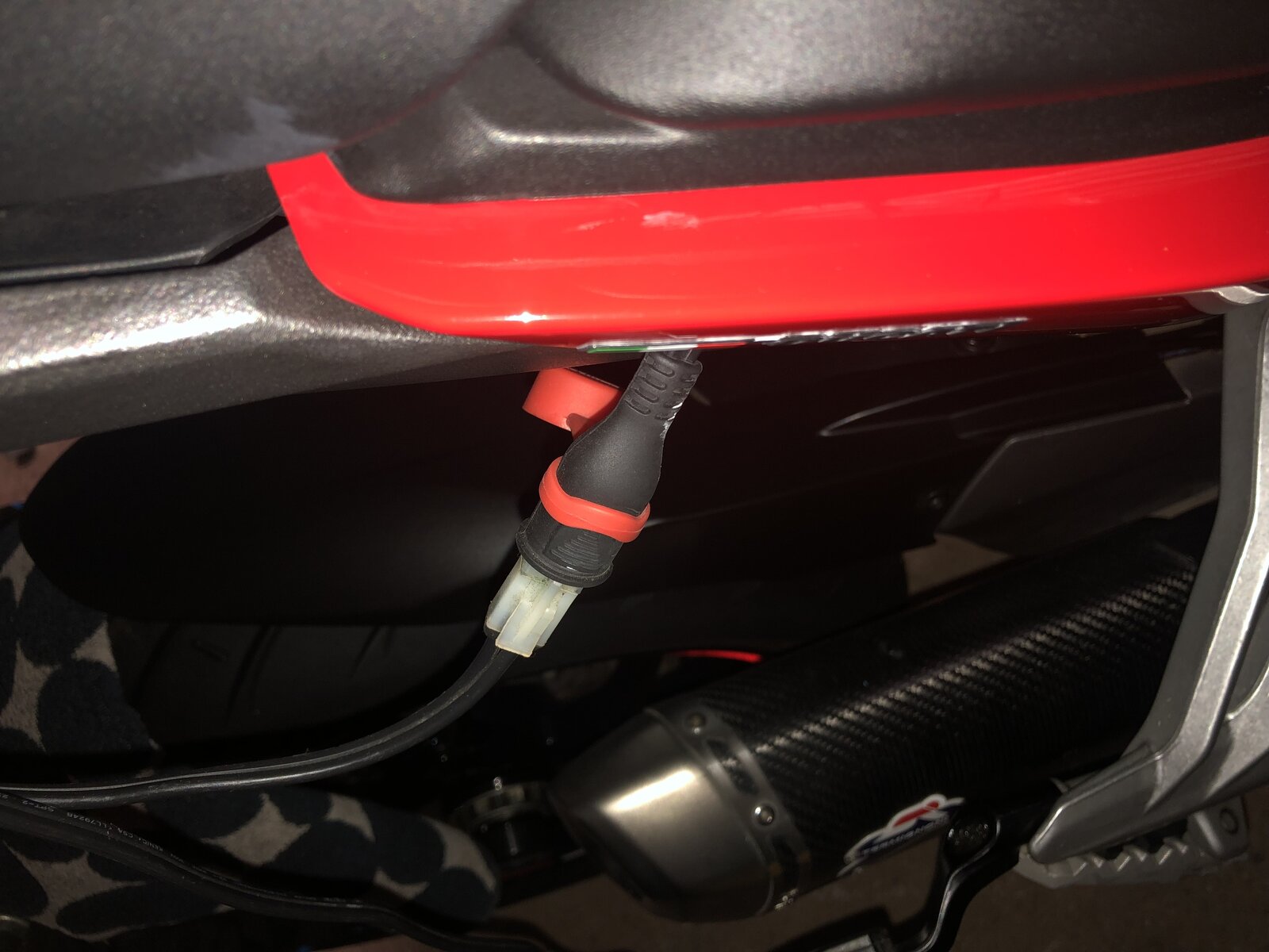

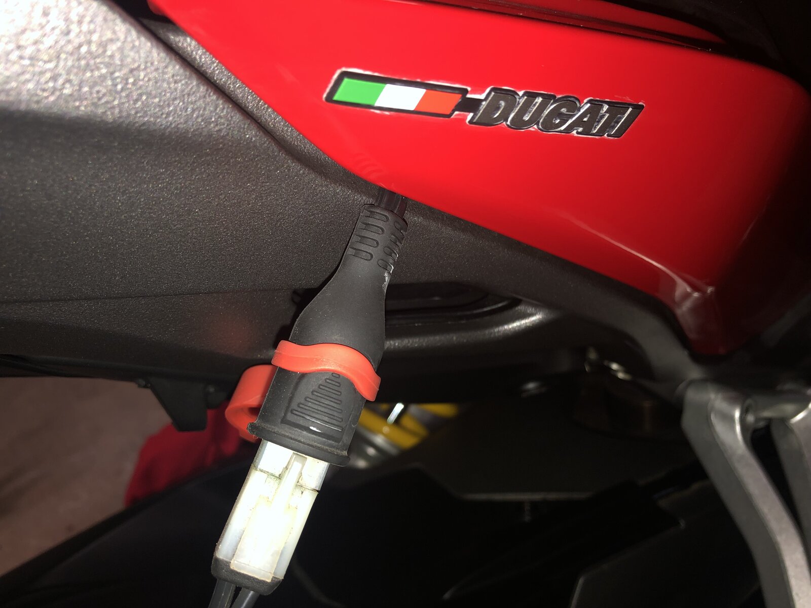

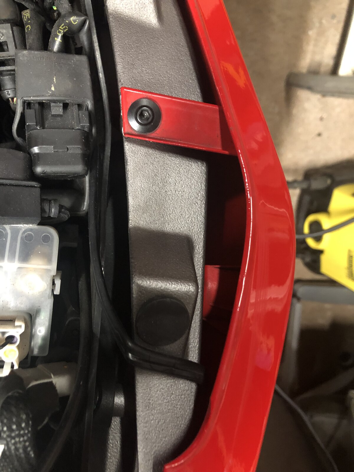

  5. On my 1260MTS, I've got mine attached directly to the battery, with the connector exposed just out from under the seat on the RHS when sat on the bike.
    I've simply routed the cable behind the seat side panels and none of it can be seen at all.
    Works brilliantly for me, let me know if you want a few photos and I'll happily send some over. :upyeah:

  9. pcn1, here's a few photos to hopefully give you some idea of the route I've taken.
    You just need to loosen off the side panel to give enough space to feed the battery connector ends behind and then across to the battery terminals. Then re-tighten and 'jobs a good un'.... 1260 above RHS side panel.JPG 1260 RHS close-up side view.JPG 1260 RHS top down under panel close-up.JPG
