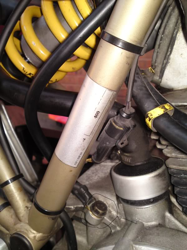

  3. Check your battery voltage & starter cable connections before you commit to a new battery - Doocat starters are notoriously poorly grounded and/or supplied with quality voltage in the first place? Random bootlace earth straps will over time degrade themselves and their connections, causing a slow chugging turnover...
    Try a jump lead from the battery earth to the engine earth, this should liven things up! Failing that try a jumplead straight from the battery positive to the starter terminal.
    The starter leads can be upgraded with car-type leads for a much better starting experience!

    Appreciate pics @ 470four !
