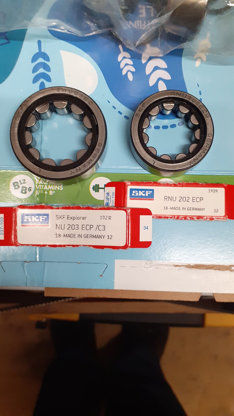

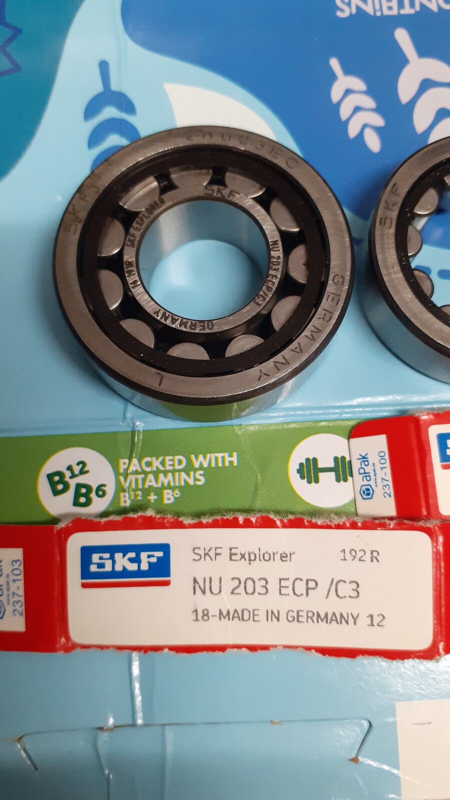

  5. Just to be clear - I am replacing SKF with SKF and same references.
    Interestingly, it seems like the Gearbox bearing was changed. The one I showed in picture states 2nu03EC but the inner sleeve on the shaft says NU203ECP/C3 and you can get those.
    But Ducati seems to sell BC1-0538 now which seems identical and such reference is available in the public too.
    So, I am curious if there is a difference between them and a reason for the change.
    On the mains, I am not finding information on the difference between the TB suffix and ETN topic. I will order from Ducati and see what I get dealt. I was just curious if somebody was in the known

    The NU203 ECP/c3 is for the gearbox. Actually the insert is useful because it sits at the end of the shafts.
    I think that the RNU202ECP is used on the layshaft and on the the cambelt caps
