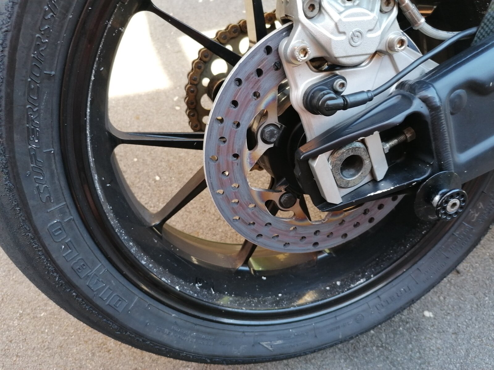

    This is what I found when I parked up...
    Molten metal on the rear wheel

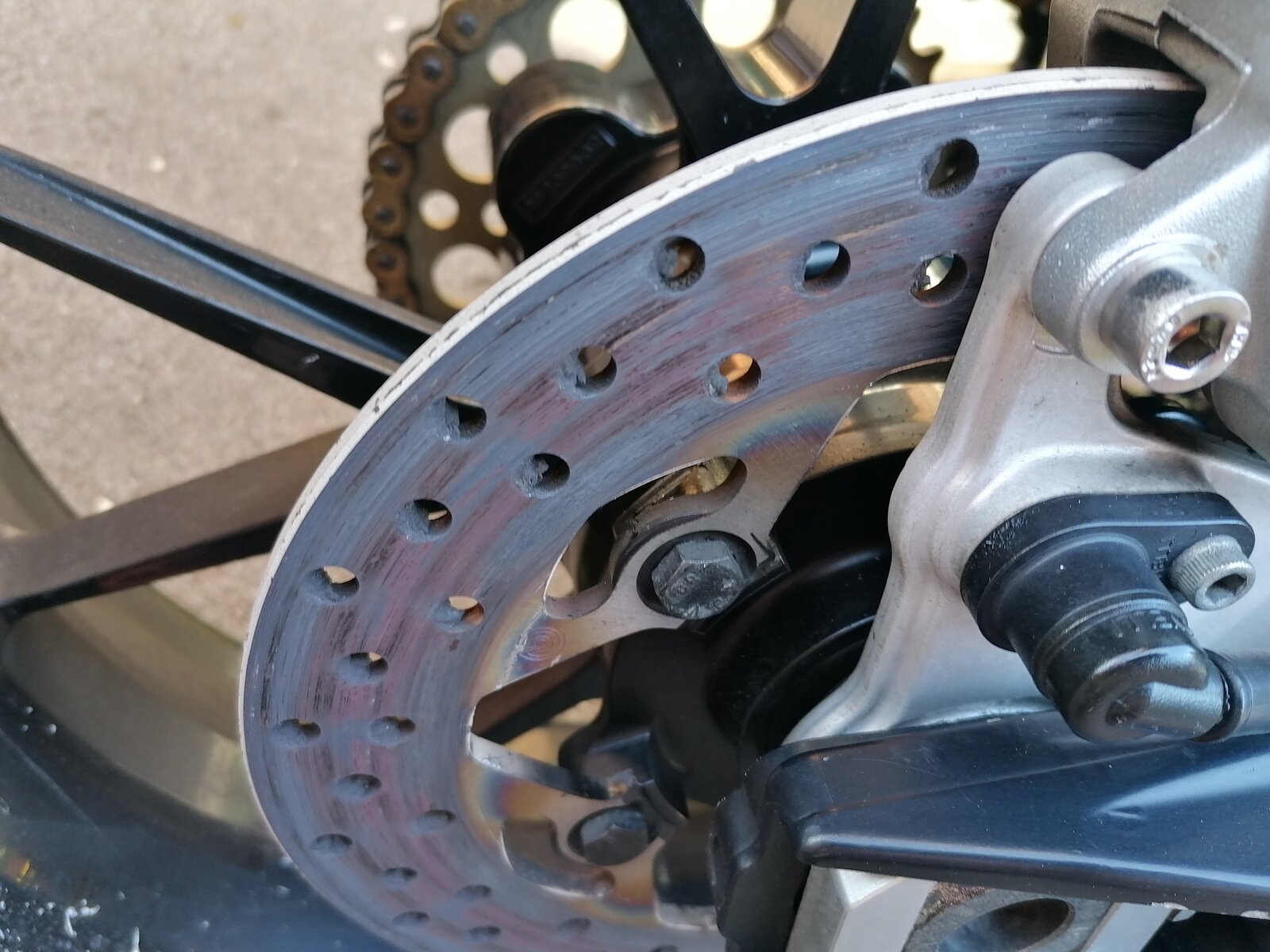

    Brake disc resplendent in NHS rainbow effect

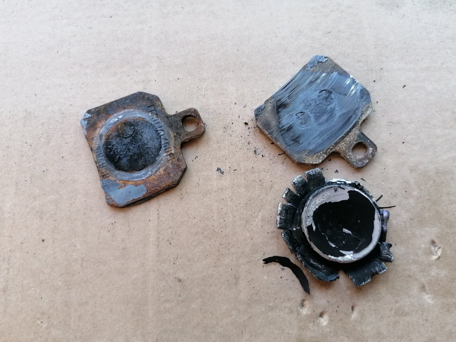

    Quick whip off of the caliper revealed a completely melted piston (black squashed thing) and pads worn to metal
    Somebody (no names mentioned...me) forgot to check that the brake wasn’t dragging when fitting the spangly billet lever...DOH!

  2. You need to give a little extra free play on the rod.

  3. plus one. Had it also on my 749R. On the track while braking the rear completely locked up.

  12. of course I don't know but heavily suspect caliper body could be distorted wouldn't you? I have "done" a few on various as probably have you, and even the steel car ones were too distorted sometimes.
