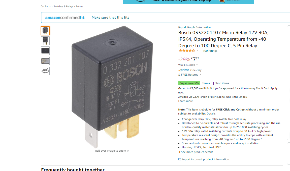

  2. Hi,I had the same problem with my evo corse this week,following the advice from Chris I replaced the 2 x micro relays to the right of the battery box and it cured the problem. Relays were £7 on Amazon for the pair. Hope this helps

    Don't just replace the relays clean the terminals they plug into.
  8. Yep had the datatool in my sights and the micro relays next. I forgot to state that it had a new battery with the cable set.

  10. Ignore the clip of the relay.
  11. Checked micro relays all good, so onto the datatool alarm. Followed cables from the alarm, one group to the tail which will just be flashing the lights. 6 cables run toward the battery box, unpeel the tape near the box and find 2 unconnected, 2 breaking into the loom and 2 going on to fuse box which are probably power and lights. Unpeel the shrink of the 2 ends where they break into the loom and link together, restoring the original wire. Battery on, key and bang, instant start. So the datatool is the issue and is coming out. Just a note I have had 4 bikes, 3 fitted with datatool 4c red, 2 have failed. Draw your own conclusions. Much happier today. So now need to resolve the blank dash.. For the moment may just buy a gps speedometer.
