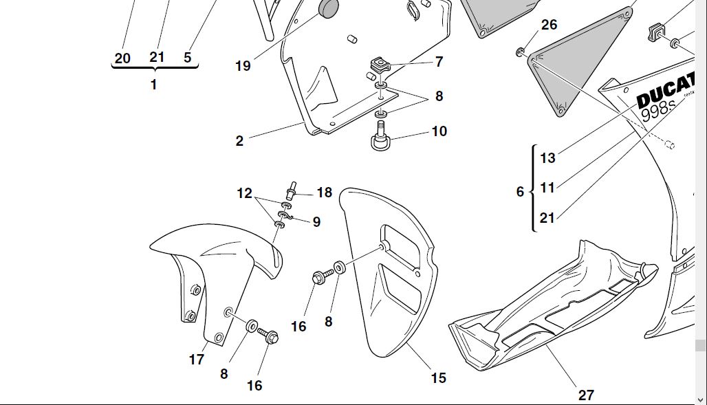

  11. The 998S does not have a full belly pan the 998RS type does. As can be seen below, there is no ability to catch oil or overflow. A 998RS style bellypan does and will fit on 998S\R panels only but not on stock 998.
    It is possible to cut a stock 998 panel to take a 998RS style bellypan but accurate cutting would be essentially, I have seen it done once though with good results.
