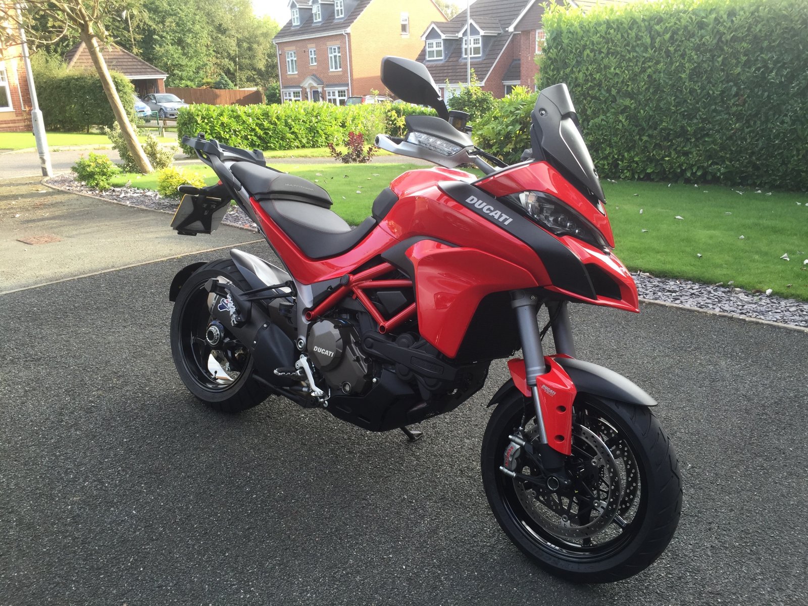

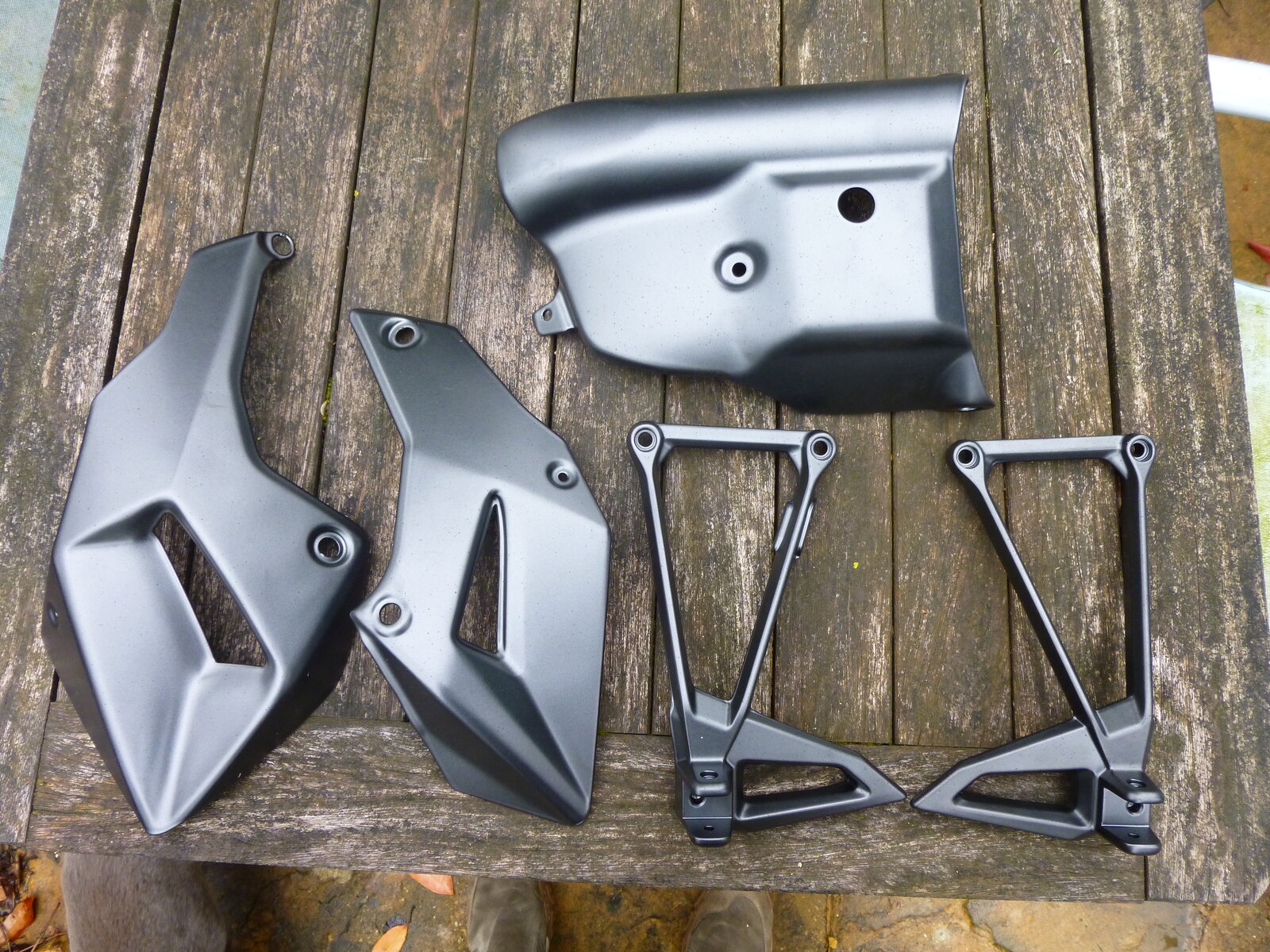

  15. Interested. Any photos?
  16. I've just had the ones for my 1260 done, I'll take a photo but these were the first ones I got done. The finish held up very well P1000610.JPG
